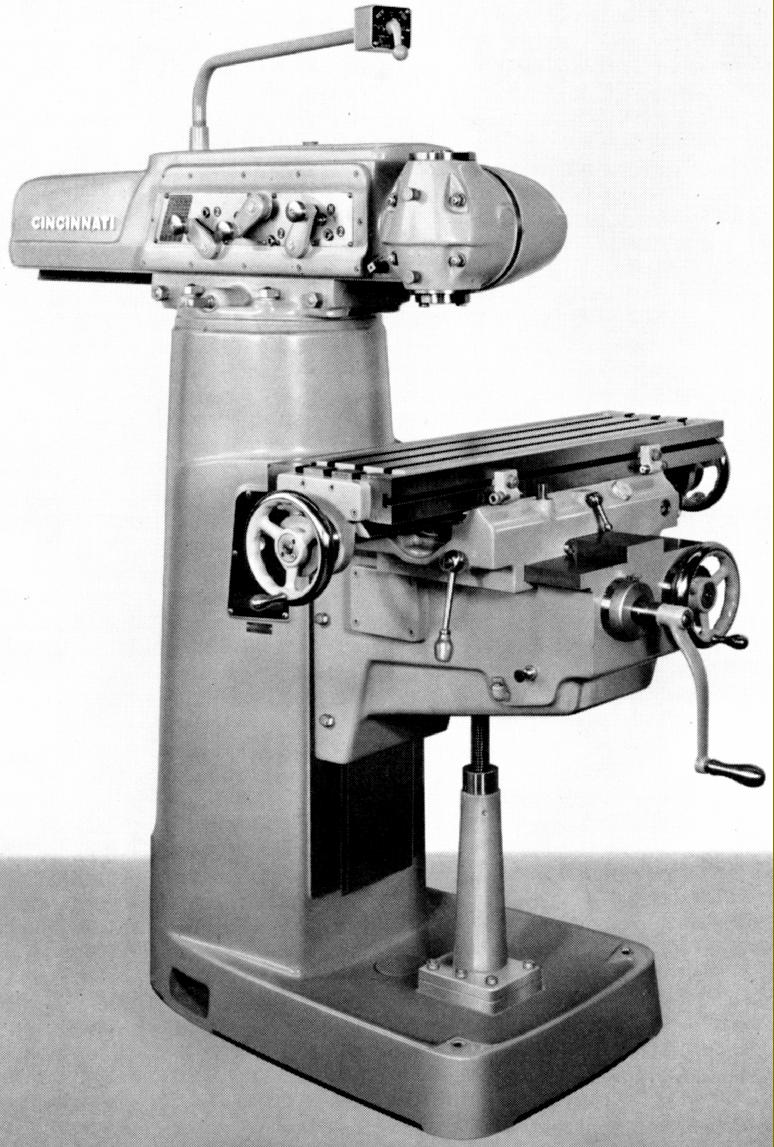

Continued: Fitted with a head having 17 inches of ram travel the 1-C was intended to be the most versatile model in the range and used the geared turret assembly offered as an accessory on other Cincinnati millers including the Dial Type, Cinedo and other general-purpose models. With a built in 2 h.p. motor and all-gear drive, this was an especially robust unit with a huge No. 40 International taper in the quill and a speed range that ran from 100 through 140, 215, 310, 490, 700, 1070 to 1530 r.p.m. Offered in standard from without quill feed (to improve rigidity) a conversion kit was available to allow the fitting of a short-travel (3-inch) spindle - though this involved the sacrifice of the No. 40 fitting and the use of a less rigid, smaller-capacity, B & S No. 7 taper. When fitted to the 1-C, the overarm was supplied complete with its vertical head mounted on a special, extended-length, double-swivel adaptor, the pair making a dedicated unit that could not be separated. This longer swivel housing was designed to allow the machine to be converted for horizontal milling, the head being rotated, to face inwards, and so provide a horizontal drive - the other end of the cutter arbor being supported in a conventional drop bracket positioned between the drive unit and column. If a non-quill feed head was required for use on the 1-B model, another version of the swivel housing was supplied. Introduced in the mid 1950s, the 1-D was an improved model and featured a much larger head with a more powerful motor (1.5 h.p. as standard but optionally, at extra cost, 2 h.p.) driving a mechanical expanding and contracting variable-speed pulley system to give a range from 85 to 3800 r.p.m. The head unit was divided into upper and lower sections: the top contained the belt drive and the lower a lathe-like backgear system (using helical gears) and (if specified at extra cost) a power-feed drive to the quill. The machine was fitted with a spindle brake as standard and the 5-inch travel quill had both rapid-action by lever and fine feed by worm-and-wheel gearing. Continued below:

Cincinnati Toolmaster Model 1-C heavy-duty type with all-geared overarm. The model shown is to basic specification, without power feed to the table.

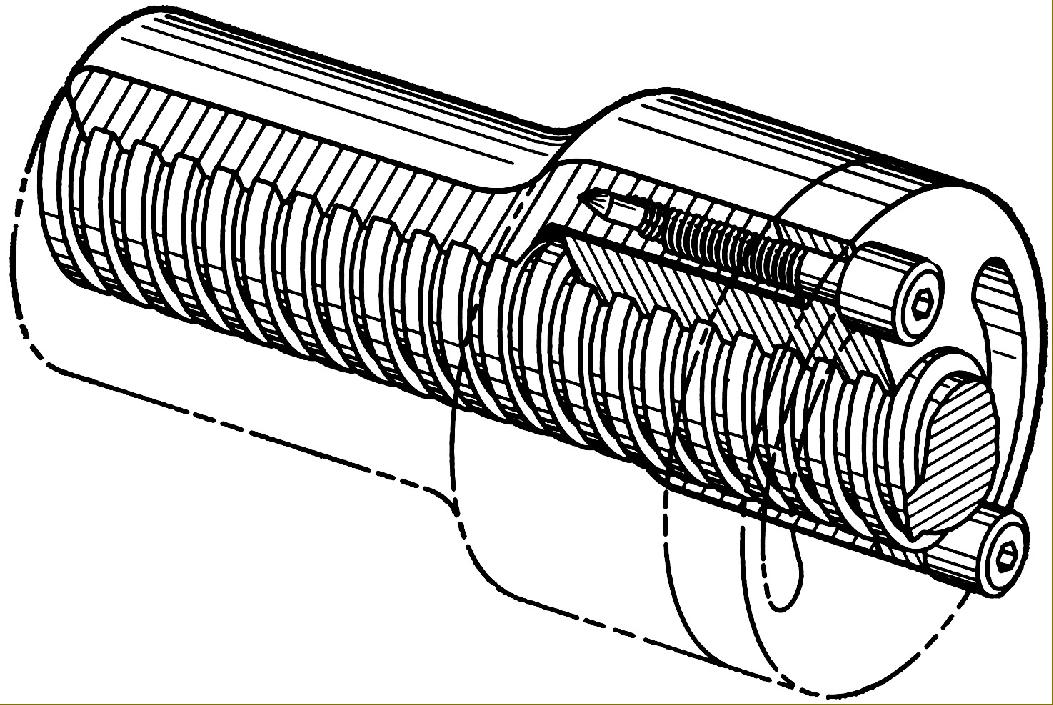

One useful fitting common to all models of Toolmaster was an anti-backlash mechanism on the table feed screw. This was not the complex unit used on the Dial Type and other general-purpose millers, but a simple arrangement where the nut was in two parts with one end of larger diameter and threaded to accept two cap-headed screws that were used to drew it laterally against the feed screw.
Ghosted view of the anti-backlash mechanism
