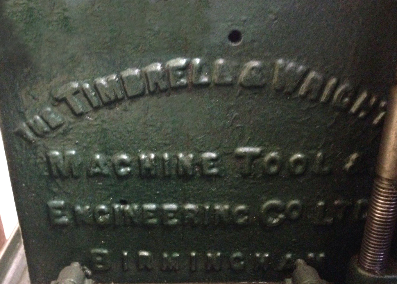

A long-forgotten maker, Timbrell & Wright Machine Tool & Engineering was based in Slaney Street, Birmingham. They appeared to have been active from the early 1920s - though possibly much earlier - and were best known for their small, robust capstan lathes, details of which can be found here.
Their milling machines are virtually unknown with the example below, a robust, simple machine of the "stub-horizontal" type, probably manufactured between 1920 and 1940 - and one of very few survivors. Much modified, with a belt-cum-chain drive to a sprocket overhung on the rear of the spindle, it would have been driven, when new, by a 3-step flat-belt pulley mounted between the plain, bronze spindle bearings and connected to either a side-mounted countershaft or (more likely) direct from overhead factory line shifting.
