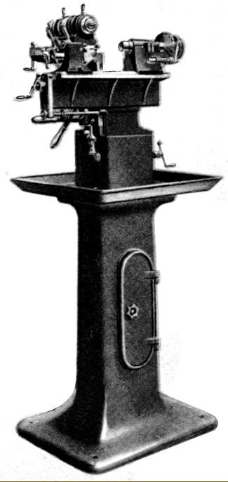

1906 Thiel - for the manufacture of punches
