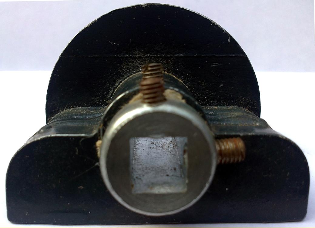

An indicator designed to assist in grinding the side and front clearances, side rake and top rake of lathe cutting tools
