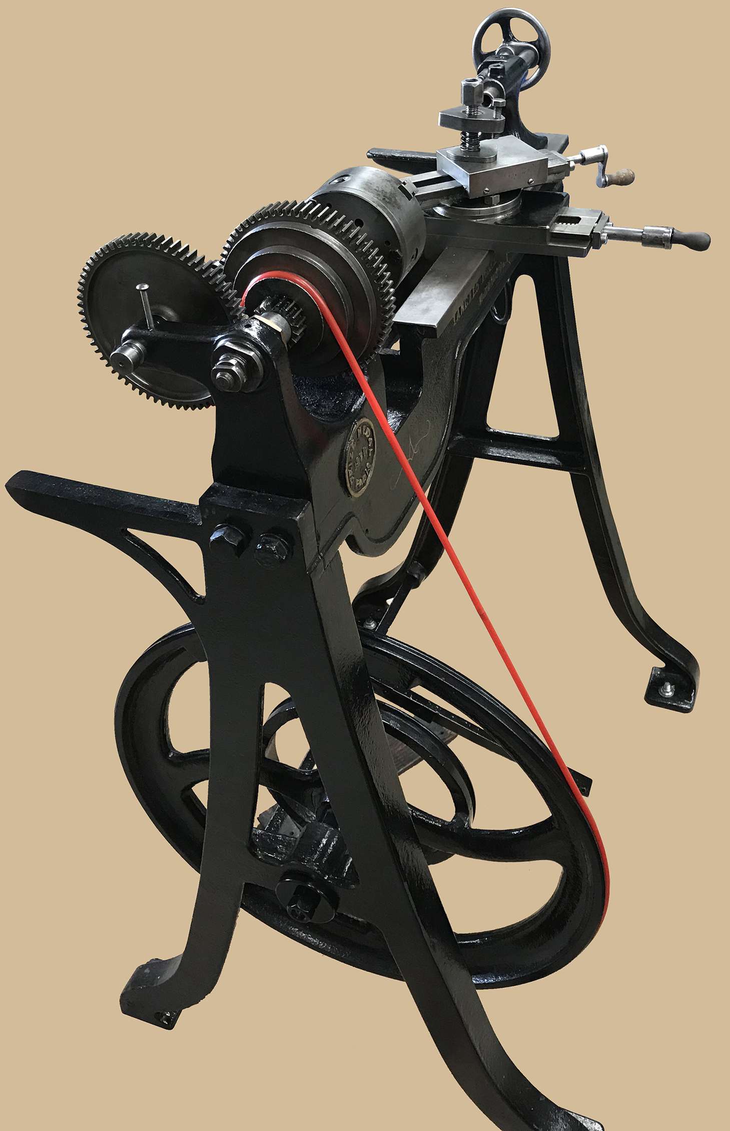

The first example of a small Tangyes lathe shown below is a carefully restored, light-duty one complete with its treadle-driven flywheel and - though lacking, as yet, the wood tool tray at the rear carried on cast extensions to the legs (this fitting being common on lathes of that era). Backgeared and screwcutting, the lathe carries a typical-for-the-time compound slide-rest assembly with the exposed feed screws operated by crank handles. The bed carries a cast-in badge proclaiming "Prize Medal Paris 1878". Instead of the usual feed by a "direct" screw, the tailstock spindle is moved by a second, parallel screw, a system also found on a number of other contemporary lathes.

A light-duty, backgeared and screwcutting Tangyes lathe as manufactured from perhaps 1880
