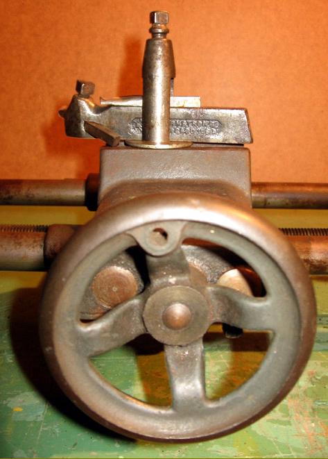

A very simple 1.5-inch travel top slide was available with two tool slots (one at the front and one at the side) cut into the body of the casting.

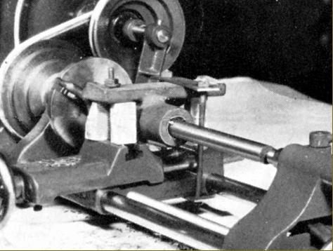

Traditional boring job using the maker's fixed steady.
