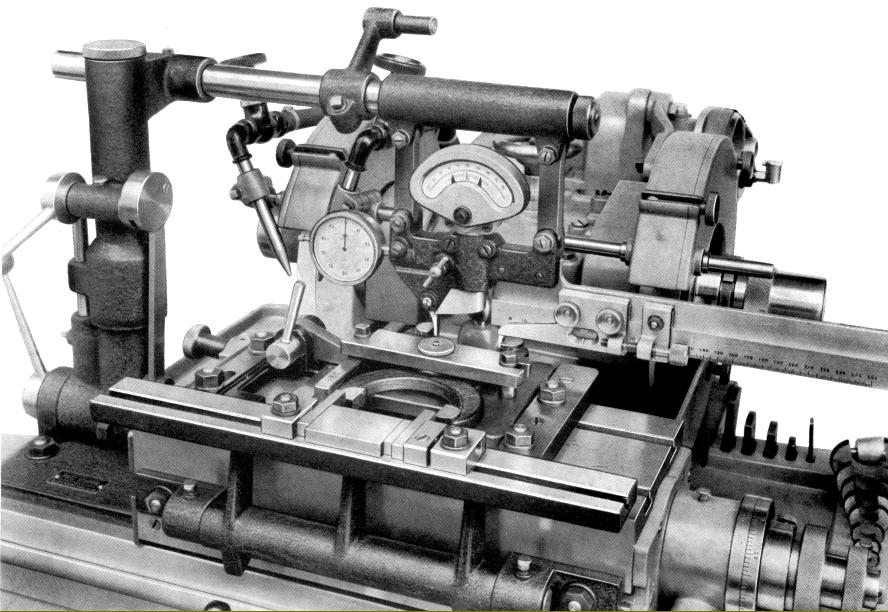

Long known for producing grinding machines of the highest quality, the Swiss firm of Fritz Studer is also active in the manufacture of machines for the setting of high-precision gauges and other measuring equipment. During the 1950s their Model RLS-300 (and larger RLS-400/1000) was offered for work to set and calibrate "snap" and other precision measuring gauges. In an engineering shop, a means of checking the dimensions of production work quickly is essential, with one of the more commonly used items for this task being the C-shaped "snap" and "go/no-go" gauges. While a snap gauge (as its name implies, it "snaps" over the dimension to be checked) can check only one tolerance - the two-ended go/no-go gauge can determine if a component lies between two upper and lower limits of tolerance - one end having a "go-gap" just above the acceptable size (say + 0.001") and the other end a "no-go" gap just below (say - 0.001"). If the part being tested passes through the "go" end, but not through the "no go", it's within the required limits. Obviously, the gauges used are made to very fine limits indeed and need to have their accuracy maintained - this latter process being the purpose of the Studer "Snap Gauge" grinding machine. Designed for preparing - by first grinding and then lapping the "anvil" faces of gauges - it could handle items with a capacity up to 8" (200 mm) while, in addition, also be employed to grind distance gauges and general workpieces that needed to be made parallel on two facing surfaces. Simple in concept, but built to the very highest standards of accuracy, the machine carried its grinding and lapping wheels side by side, thus enabling work to be carried out at a single setting. The accuracy achieved depended, to some extent, upon an experienced operator who, with suitable care, could achieve results within the range of plus or minus 0.000040" (0.001 mm). Continued below:
Studer RLS-200 Snap Gauge Grinding and Lapping Machine shown holding a double-opening gauge and fitted with the work-holder table and measuring apparatus

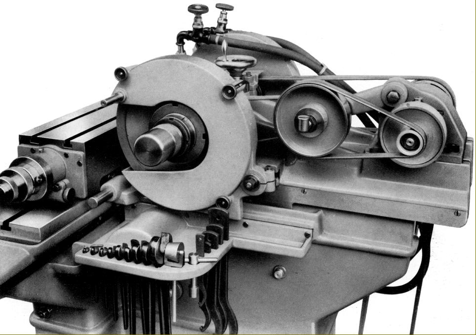

Continued: Flange mounted against the left-hand face of the machine's cast-iron stand, a single reversible motor was used to power the entire mechanism, its drive being arranged to run in two directions: first, passing right through the stand to emerge from the opposite face from where a smooth-running flat belt - inimical to the onset of vibration - that took the drive upwards to the linkage that imparted a front-to-back reciprocating motion grinding wheel slide; second, the drive was taken rearwards, by another flat belt, to a pulley mounted on an external swinging arm and from there upwards, by twin V-belts, to a countershaft on top of the grinding wheel slide. Located so the belt tension could be adjusted in two transverse T-slots, the countershaft had its driven pulley between two bearings with, a flat-belt pulley at each end driving the grinding and lapping wheels. The wheels were driven separately at different rates, the grinding having a peripheral speed of about 72 ft/sec. (22 m/sec.) and the lapping, using a double-step intermediate speed-reduction pulley, at the slower rate of 11 ft/sec. (3.5 m/sec.). If the job required it, the lapping disc and its speed-reduction pulley could be removed and a second grinding wheel mounted in its place. In addition, another pulley on the motor shaft drove, by a round belt passing over a pair of jockey wheels, the coolant pump, this being mounted together with its tank on the left-hand face of the column. Aiming to provide perfect concentricity, the makers arranged for the grinding and lapping wheels to be carried on collets, these being mounted on steel quills fitted with tapered and adjustable bronze bushes (sealed against grit) that turned on fixed studs. When very thin wheels were needed - to grind gauges with an opening of less than 0.25" (6 mm) - the design changed, with the thin and hence fragile wheels still collet mounted but given additional support by metal flanges that covered the greater proportion of their diameter. A spring-loaded, ball-thrust washer took up longitudinal play of the grinding wheel spindle, while the bush of the lapping wheel was also spring-loaded in both directions to push it, very lightly, against the workpiece. In action, as the lapping wheel bore against the job, the grinding slide was reciprocated, rapidly, front to back; when one face had been lapped, by the right-hand turning disc, the motor was reversed and the other face finished by the other disk turning to the left - the makers claiming that this arrangement resulted in an improved parallelism of the two surfaces. To free the wheels from the effect of belt pull and the possibility of distortion, each was fitted with two dogs that engaged with holes in the face of their drive pulley. In addition, as vibration-free running was essential, the wheels had to be balanced, this being achieved by the securing collets carrying weights adjustable in a circular slot - a balancing arbor being supplied with each machine. To assist with accurate balancing - but at extra cost - a balancing device was offered, this having a cast-iron base fitted with two levelling screws and carrying a pair of hardened and ground parallel bars, set horizontal by two built-in spirit-levels, on which the wheel on its arbor rested. So that the grinding wheel could be trued up in place, a pair of diamond holders was mounted on a bar in front of the wheel, each being arranged to dress one side of the stone. Lapping discs were made from a special, fine-grained cast iron that was charged with a lapping compound, this being applied by a hardened and ground steel roller fitted with a handle - a sample tin of a suitable paste being supplied with each machine with further (no doubt very expensive) supplies available from the maker. Before being charged with compound, the lapping wheel had its axial play removed by the tightening of a nut and then trued by being ground flat on both sides, the work being performed by another extra-cost attachment, a motor-driven grinding head. However, as the head could be moved from machine to machine as required, only one was required. So that the grinding wheel on the grinding head was, itself, perfectly true, a diamond holder was fitted to the grinding slide and the wheel trimmed before use. As the rotation of the motor could be electrically reversed, each side of the lapping wheel could be ground so that the opposing surfaces moved in the opposite direction relative to each other. Continued below:

Left-hand side of the Studer RLS-200 showing the speed-reducing pulley set used to drive the lapping wheel. Note the typically neat Swiss tool storage facility - absolutely no excuse at all to lose an item

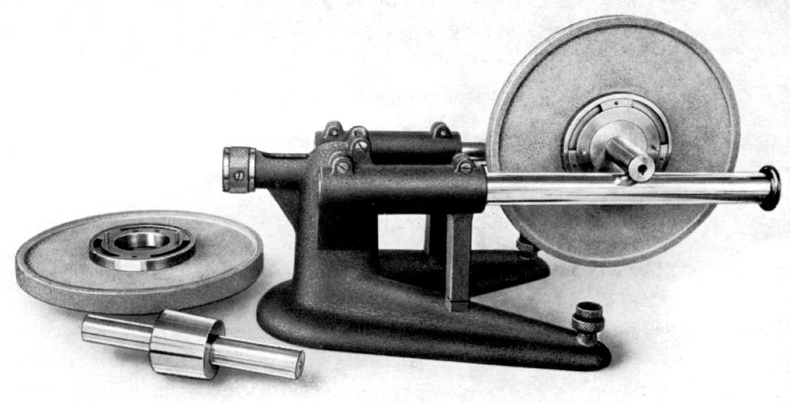

Lapping disc with its collet, extractor nut and the roller by which means the lapping compound was applied
Wheel balancing device: a pair of hardened and ground parallel bars, set horizontal by two built-in spirit-levels, that carried the arbor and grinding wheel

The measuring apparatus being adjusted by using gauge blocks set in the front holder
Measuring apparatus in position taking a reading. In use, the operator swung the apparatus gently backwards and forwards; when the job was finished, and before dressing the stone or lapping wheel, the whole assembly was hinged backwards to be clear of splashing coolant and grinding dust.
