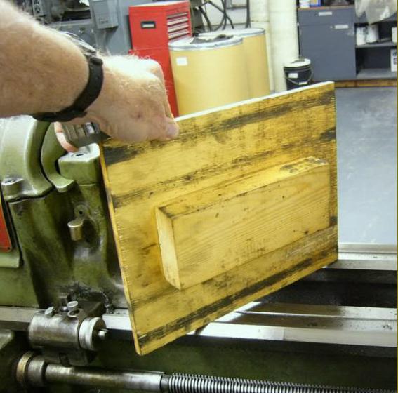

Stage 4
You might like to attempt the manufacture of the very effective "chuck removal tool" shown on this page" http://www.practicalmachinist.com/vb/south-bend-lathes/how-remove-stuck-chuck-tutorial-165028/
In case the instructions and illustrations on practicalmachinest.com are lost, the pictures are repeated below.
