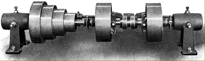

Countershaft listed for lathes with 14", 16", 18" and 20" swings. The two single right-hand pulleys ran in different directions and were locked to the shaft by toggle-operated clutches
