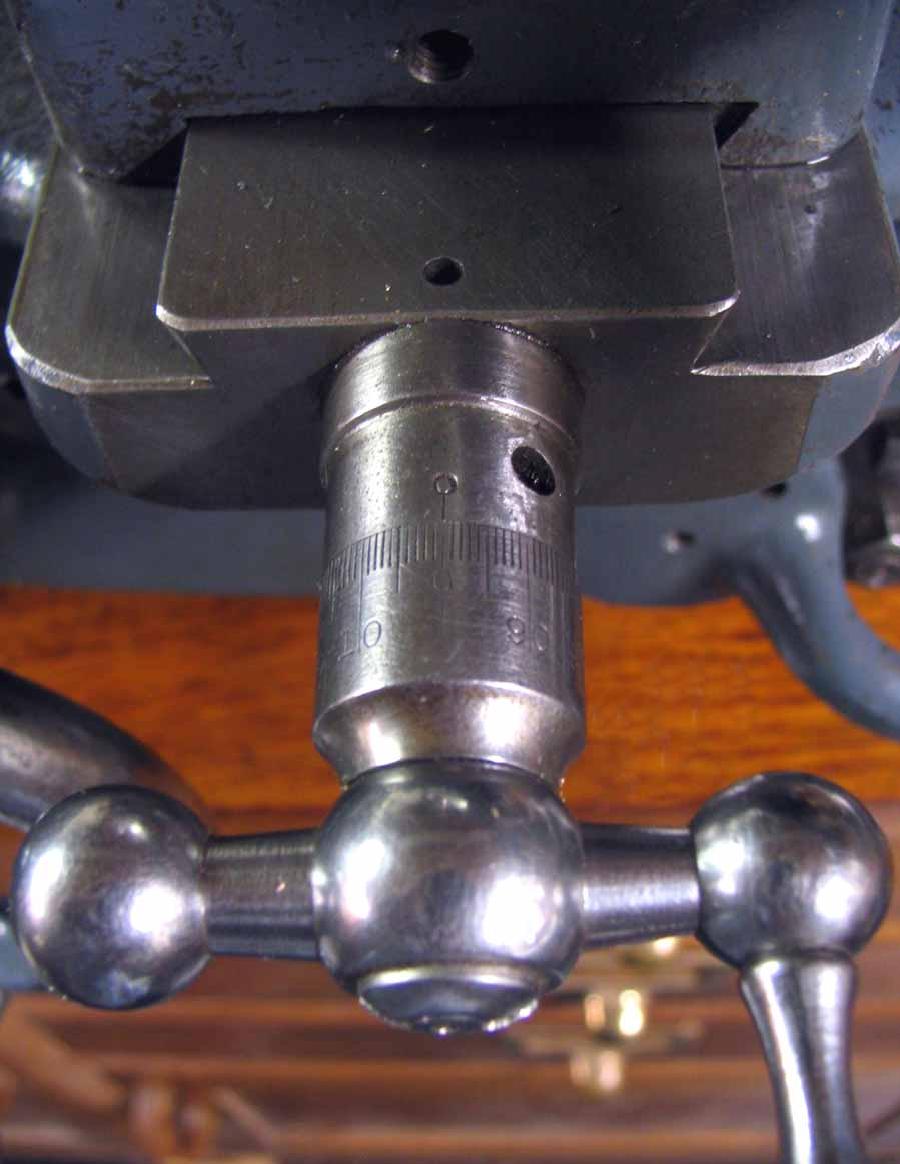

Model 5 Type 405 top-slide feed-screw handle and micrometer dial
