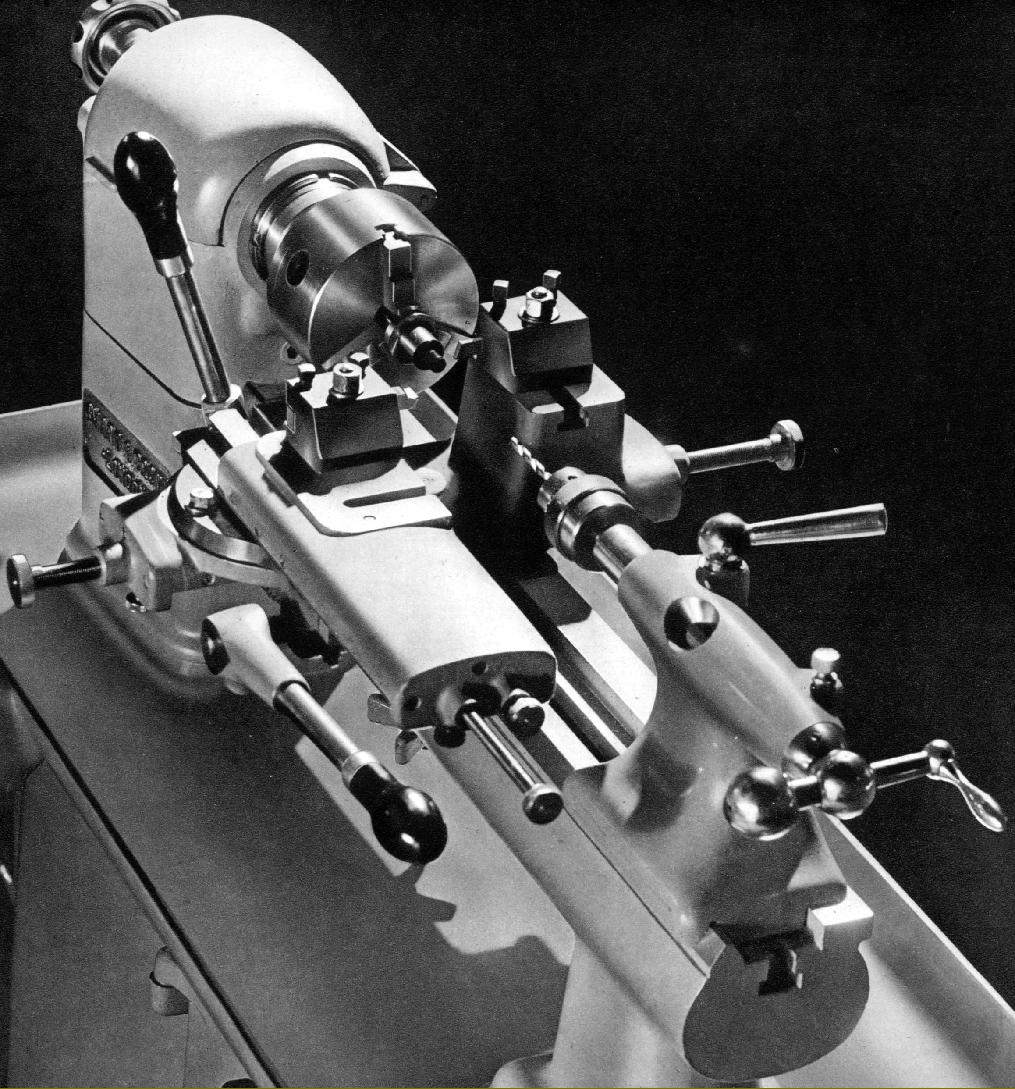

Smart & Brown Model L set up as a second-operation lathe will all-lever control of collet-closer, slide rest and tailstock

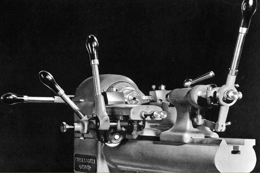

Another view of the all-lever controlled second-operation lathe
