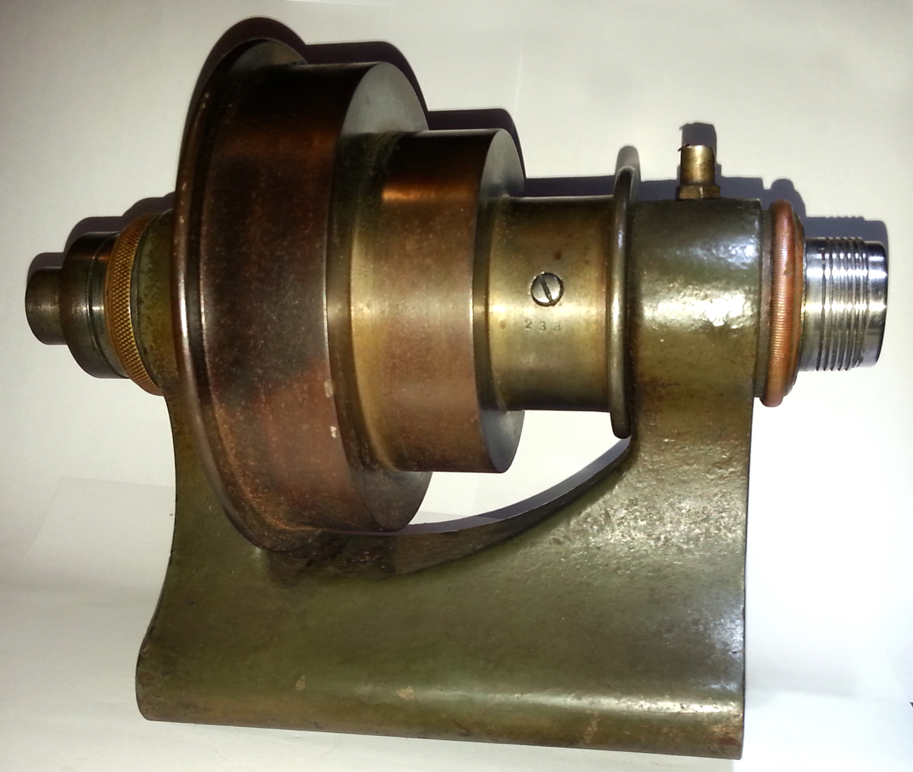

Sloan & Chace headstock spindle with its square-section thread
