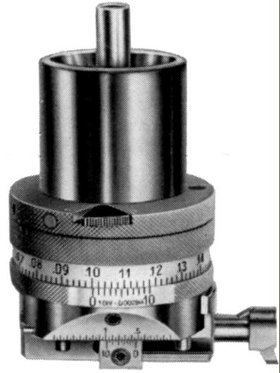

Depth-measuring device with micrometer stop. This unit could be mounted instead of the standard-fit dial indicator. Read in 0.001 or 0.01 mm. The unit shown has metric graduations.
