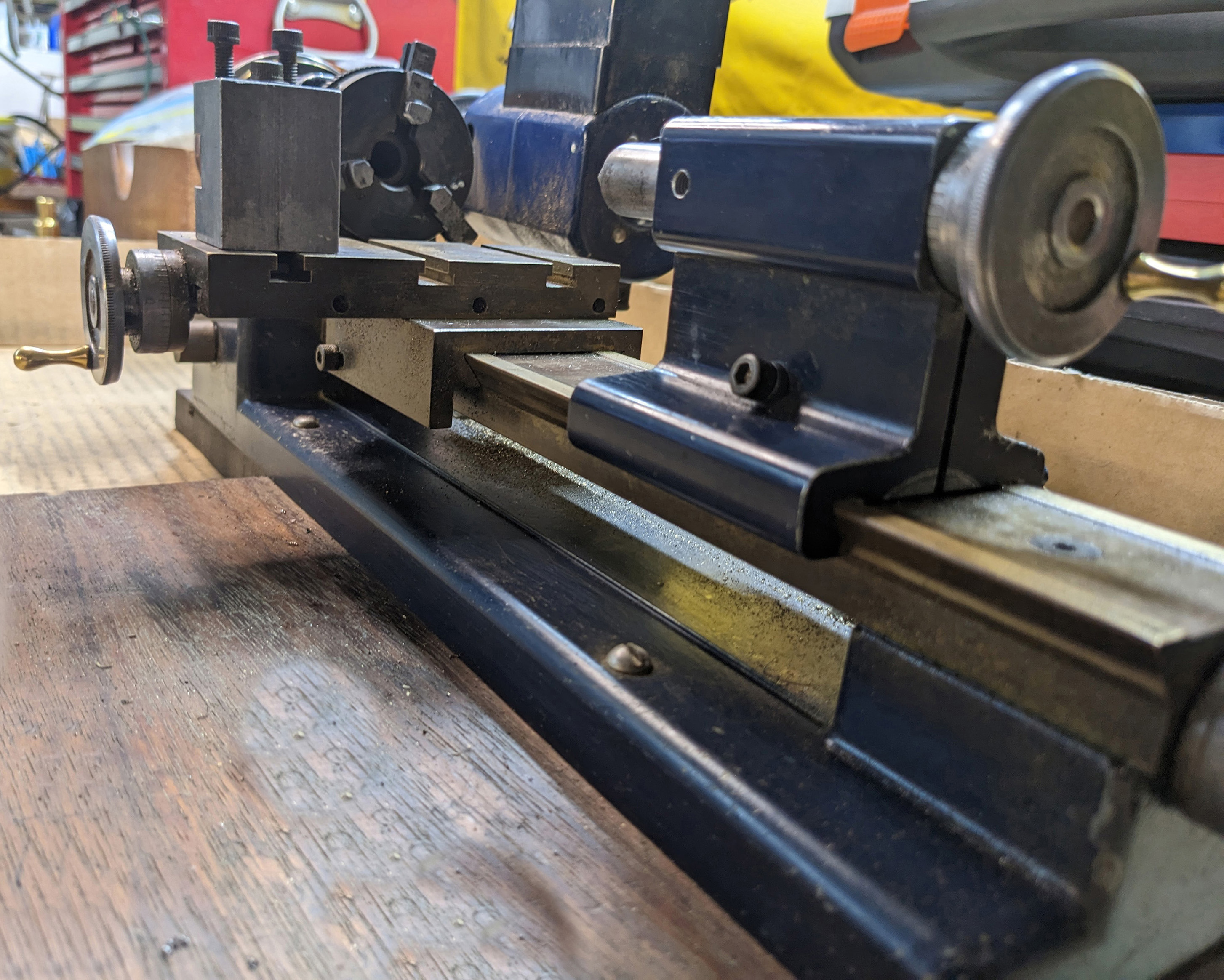

An early example of a Sherline, the Model 3-inch Precision
