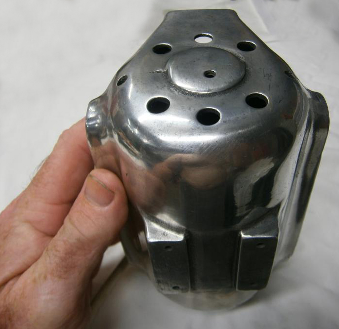

Saved by Mark Harris, the drill was recovered, in a very neglected condition, from a garbage dump recycling shop, an employee telling the story that it came from a skip full of somebody's basement instrument repair workshop - and was the only item (from amongst all the small tools and hardware dumped in the landfill mud ) that was recovered.  Upon examination, the Sher proved to be especially well built, the drilling function being by a lever-operated rack-and-pinion drive that moved a round table - of cast iron -  up and down on a solid steel column that socketed into the base casting. To set a fixed drilling depth, the lever shaft carried an adjustable boss that ran up against a stop pin set into the side of the base. As the table's vertical travel was only slight, for coarse settings the 10,000 r.p.m., the 230 Volt, 1.3 Amp "Universal" AC/DC motor could be slid up and down the main column - and locked at the desired height. The new owner reports that the motor was not too bad internally, with just a small amount of rust on the stator laminations that came off easily. The rotor windings were coated in a thick, clear resin and looked like new, though the commutator and brushes were worn. New, oversize brushes were sanded down to fit and the commutator skimmed in the lathe.
One bearing was a bit worse for wear and looked as though it had spun in its housing - with whoever had replaced it crudely prick punching the journal to secure it; the bearing was sliced with a grinder and the inner race cracked to get it off. The iron castings had a few areas with the original black finish preserved under layers of fine brass dust and hard grease - the black looking just like the old-school iron finish of lamp black mixed with shellac. The 1.5-inch diameter steel post caused a bit of a problem as it appeared to be secured in the base by a blind stud or possibly a taper pin; however the fastening eventually revealed itself to be an old bicycle-style crank cotter pin - the motor-casting-to-post fitting being identical: simple, effective and economical. Everything rusty was sanded off in the lathe and a coat of grey acrylic Hammertone paint applied. The aluminium motor housing looked to be black-sand casting and unpolished in its original state. Some basic fettling of the castings was undertaken with sanding of the filing and grinding marks with wet and dry before giving it a heavy polishing buff. After a bit of careful assembly - and the new commutator bearing secured with a medium-strength threadlocker -  the whole machine was back together again. As a test, a 100 Watt bulb was put in series with the motor and power applied; as it spun slowly with no fireworks it was given the full 240 volts and spun up nicely - not even being as loud as one might expect from a 10,000 r.p.m. unit (that runs at 13,000 r.p.m. under no load).
As similar small drills for printed circuit boards work and drilling lenses in optometry work are around $2000 new, the re-builder is justifiably pleased with how the job turned out, it cost just $100 plus some enjoyable, spare-time work - while also preserving a bit of Australian power tool history.
