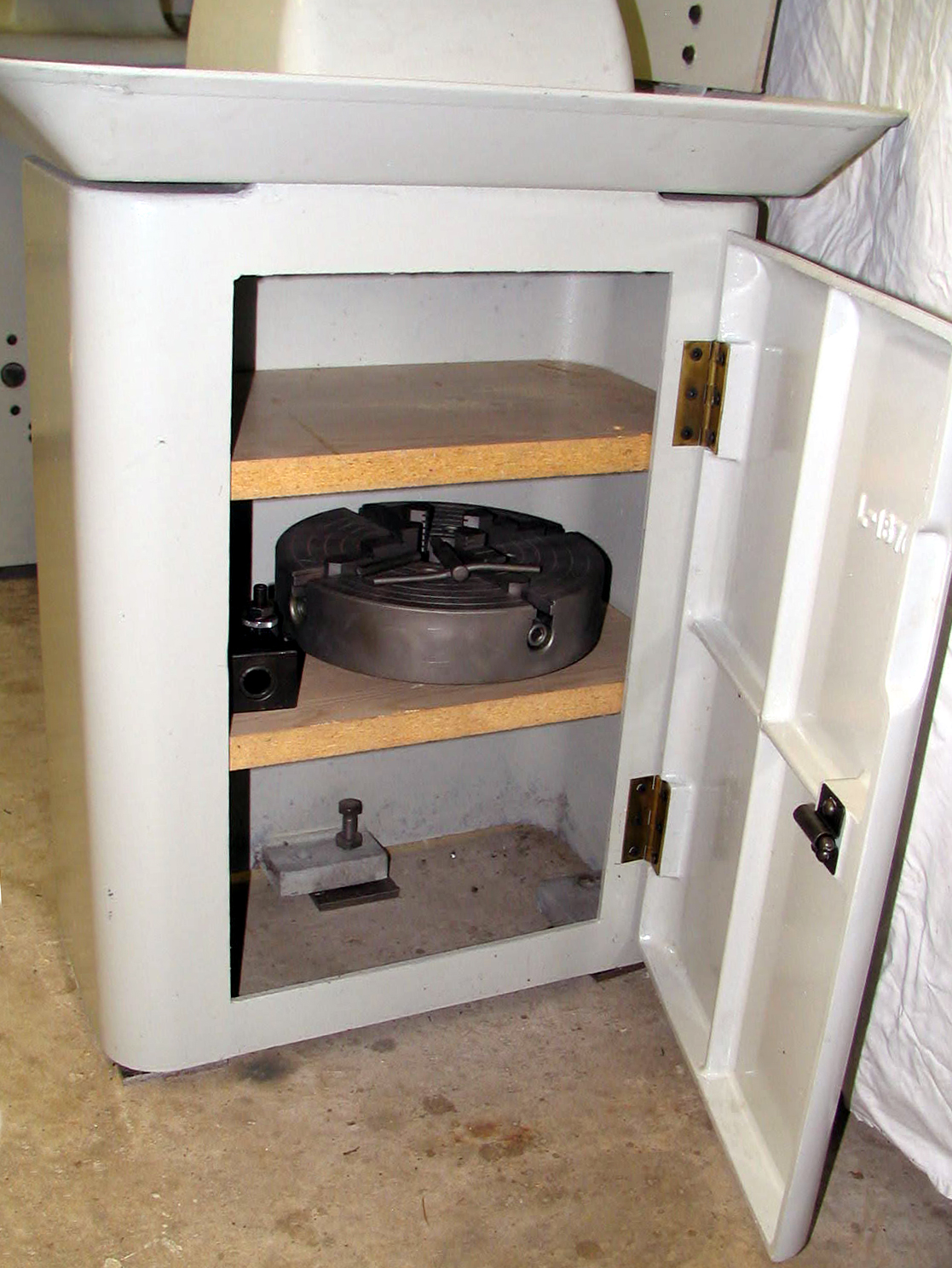

Shown below is a rare Sheldon lathe from circa 1958, a 13-inch M Series model with the Serial number 22925WM - the "W" indicating that this was example was supplied mounted on an underdrive cabinet stand. This version is normally found fitted with a Merkle-Korff Gearmotor unit that consists of a push-button-controlled electric motor that opena and closes - using a chain drive - the expanding and contacting pulleys of the variable-speed drive.  However, although the model shown has the same type of mechanical variable-speed drive with a wide V-belt, the control is manual, with a red-painted handle emerging from the front face of the cabinet above and to the right of the door opening. Connected to the handle is a long rod that engages with a flat-faced jockey wheel; pushing the handle down or lifting it up causes the jockey pulley to engage against two V-belts that, in turn, drive a shaft to move yet another shaft that opens and closed the variable-speed pulleys. Although having the appearance of a nightmare contraption, the system is reported to work well.
Sheldon obviously had second thoughts about the installation, and replaced the manual system with the electrical one mentioned - though unfortunately the motor chosen by Sheldon was to be phased out and today there is, apparently, nothing to replace it (at least the 'walking stick' mechanism is repairable and uses just simple parts).

Badly neglected when found and very rusty, this "Walking Stick" M-Series Sheldon has been beautifully restored to working order.
Details of the manual speed-change mechanism
