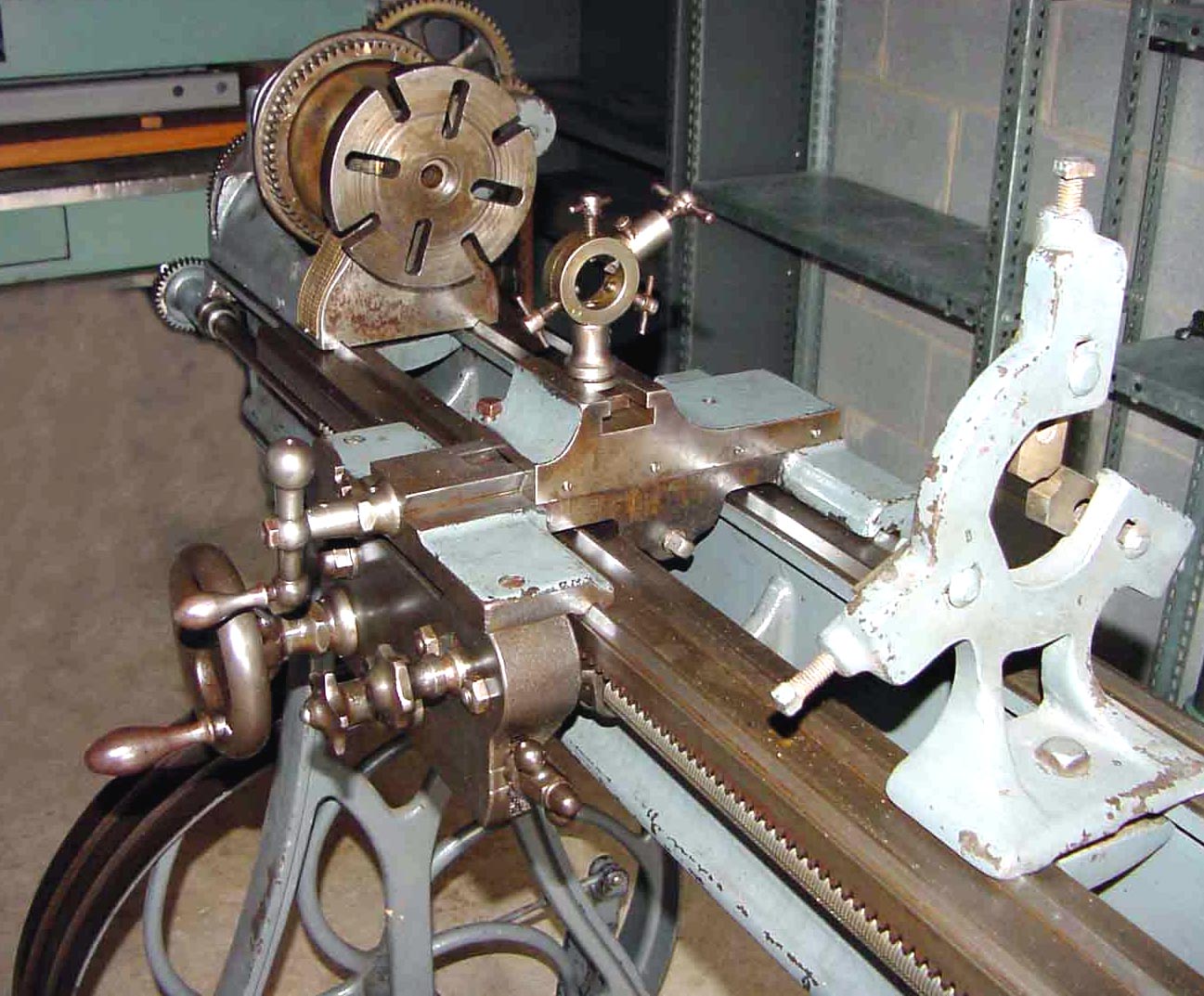

A standard Seneca Falls Star 10", 12" and 14" lathe of the mid 1920s with screwcutting by changewheels and power cross feed. This range of smaller lathes was available for bench mounting or on floor legs with and without a chip tray -whilst and the 10" and 12" lathes could also be supplied fitted with a treadle drive. Of 60-65 carbon crucible steel and finish ground (but not hardened), the headstock spindle ran directly in the cast iron of the headstock with oil-thrower rings to splash the lubricant around. This apparently crude system (also used by South Bend on many of their models) works extremely well and gives an astonishingly long life, the free graphite in the cast iron providing lubrication even when oil is lacking. Some, if not all spindles, were fitted with a spigot behind the thread to more securely locate the fittings screwed on to it - by no means a common precaution at the time. Able to be engaged without having to use a spanner, the backgear assembly and the large cone-drive pulley were both finish turned on the inside and correctly balanced for smooth running at higher speeds. Running on a bed with the usual American-type V and flat ways, the saddle was fitted with keeper plates (or "gibs") at both front and rear. The cross-slide was fitted with an adjustable stop and its screw fully covered and fitted with a rather small, but zeroing, micrometer dial. While many makers of even quite large lathes were content to fit a tumble-reverse mechanism driven from a gear on the end of the headstock spindle, and to run the reversing gear train on pins having support on one side only, Star positioned the reversing drive to the leadscrew underneath the left-hand end of the headstock spindle, allowing a slightly more rigid assembly to be created. The appearance of the round-headed tumble-reverse control lever and its slot were surprisingly like that fitted to the English Drummond lathe. Rounded covers guarded the changewheels with the cover doubling - by the use of pegs on the inside face - to hold spare gears neatly in place. The changewheels were fitted with "retained" split-spring washers which enabled the gears to be slipped on and off quickly when changing the screwcutting ratio. Slotted so that it could also act as a power shaft, the leadscrew passed through a bronze worm carried on the inner face of the apron - a key drive providing both a slow rate of sliding feeds as well as a power cross feed. The selection and clutch engagement of feeds was controlled by independent "star" shaped handwheels on the apron's front face. Like a South Bend, all small screws, nuts and other components, which might be bruised in the course of routine maintenance were case hardened to protect their appearance. Standard equipment consisted of both large and small faceplates, two centres, fixed and travelling steadies, changewheels for screwcutting, a drop-forged tool-post wrench and a countershaft assembly. If you are restoring one of these lathes you might like to know that they were finished with: " …five coats of filler and oil-proof paint leaving a smooth, easily cleaned surface."..

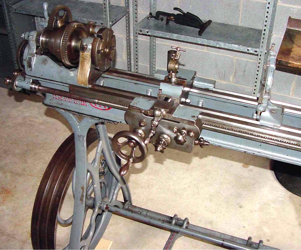

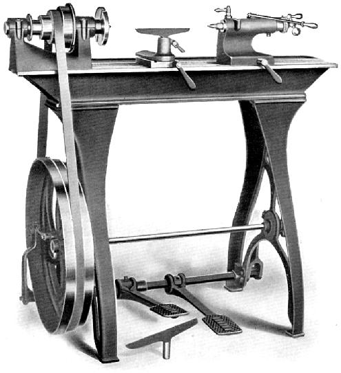

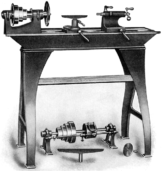

Seneca Falls "Gem" lathe of 1889 "Gem" used by various manufactures for their models including, in the late 1800s, the Fitchburg Machine Works of Fitchburg, Massachusetts and more recently an English company for their round-bed lathe manufactured during the 1970s - but Seneca Falls may well have been the first, their little plain-turning Gem lathe first appearing in publicity sheets during 1889. The lathe was intended as a simple, plain turning machine with a 3-inch centre height and a capacity between centres of 18 inches. The 5/16"-bore headstock spindle ran in adjustable bronze bearings and carried just a 2-step, flat pulley for inch-wide belt that could be driven by either a wall or ceiling-mounted countershaft or, at no extra cost, from the maker's unusual, and very ornamental, double-treadle foot-power stand with overhung flywheel. The treadle mechanism, which featured two independent and individually-adjustable pedals, could be operated either standing up, in which case just one pedal was used or, if more power was required, by sitting down and operating both; the mechanism was also used for some years on the company's larger lathes. Supplied as standard with the lathe were two T rests and their bed-mount sockets, point, cup and spur centres for metal and wood turning - and a leather driving belt. Seneca Falls went on to use the "Gem" name on a range of larger machines, though they were also sometimes entered in catalogs as "Speed" models, a term usually reserved today (in the USA) for a simple headstock and hand T-rest or compound slide assembly used for polishing and very simple turning..

The 10" and 12" Seneca Falls Star lathes were available on "walking-motion" treadle stands …. ideal for winter evenings in New England - but not summers in Florida. The design was probably first used on a Seneca Falls lathe (it was not their invention) when the "Gem" model was introduced.
