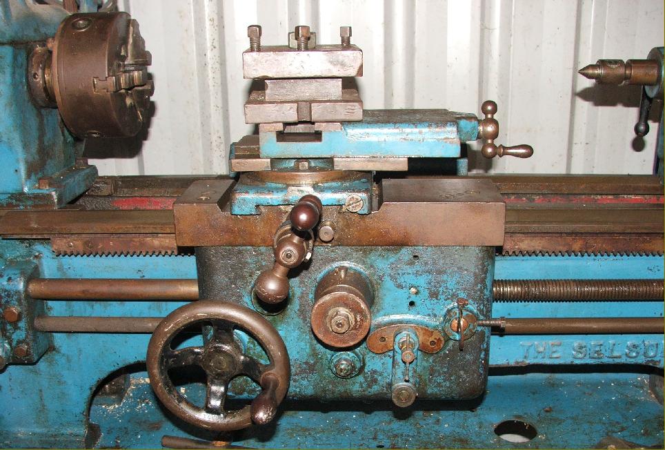

Typical examples of Selson-badged machine tools include Volman and Robot and Colchester lathes disguised as Osborne.
A typical geared-head Selson manufactured by the Simplex Company of in America. This model was sold from the early until late 1930s onwards branded, in the United Kingdom, as the "Regent"
Another Simplex, this one carrying a brass nameplate
This Selson-branded Simplex has the Selson name cast into the easily-changed headstock plinth door
The door might have been changed but there was no hiding the Simplex name on the screwcutting chart…..
Simplex/Selson tailstock
