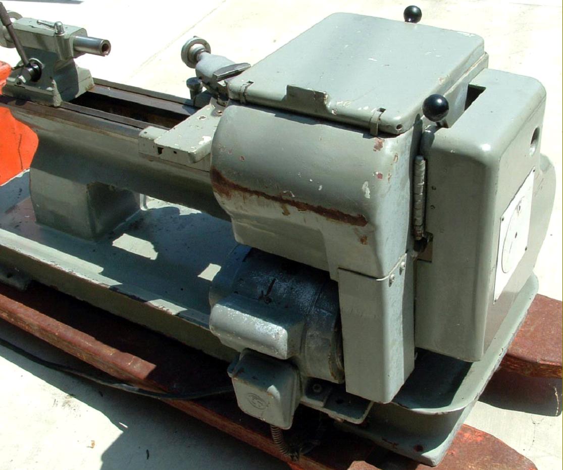

The Lin Huan branded as a "Select" 816B
The Lin Huan branded as a "David". When new this example was supplied complete with a reverse/forward/stop switch; 4 jaw chuck; metric transposing and English screwcutting changewheels; travelling steady; faceplate and a  service manual with initial alignment values and codes for spare parts.
Another model of Select lathe
