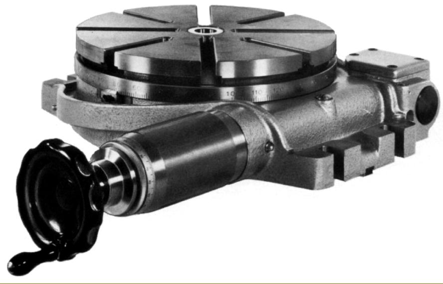

Schaublin rotary table with interchangeable division plates in place of a handwheel
Schaublin plain  250 mm rotary table complete with a drive system for use on the Type 22. 8 radials 12 mm T-slots were fitted with the centre hole being a No. 2 Morse taper.
