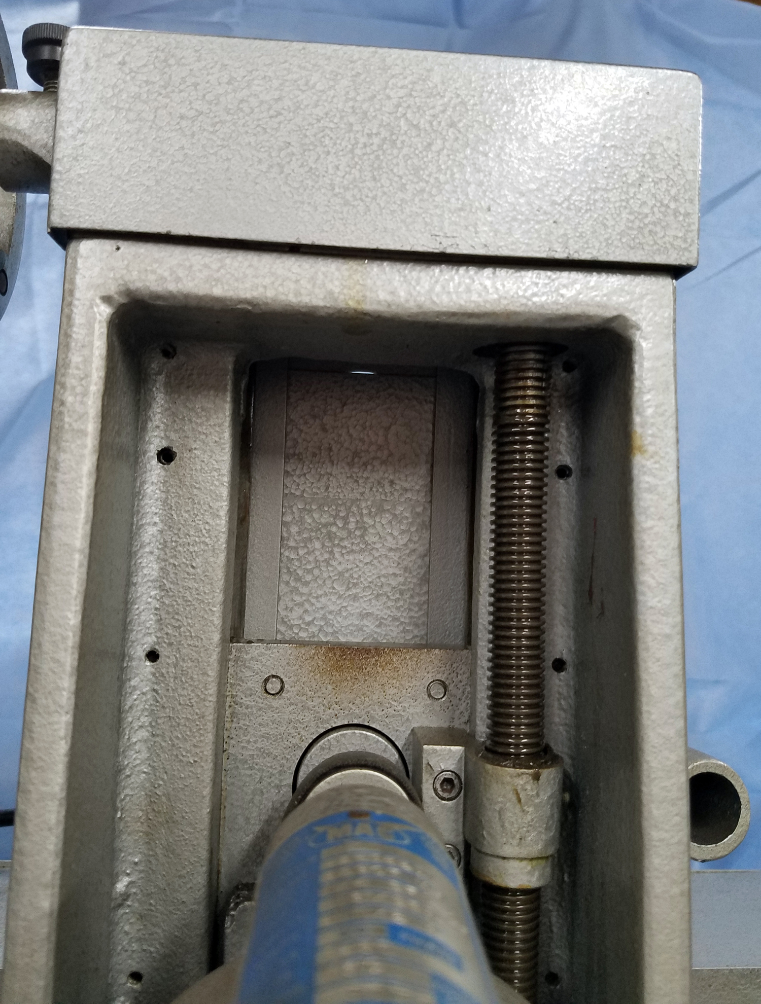

In addition, the operation of the vertical leadscrew was reworked so that it no longer rose above the top of the upright, instead it remained within - its basic operation being reversed as follows: on early machines the screw had been fixed rigidly to the spindle carrier and threaded through the (handwheel-turned) top bevel gear.  Hence, as the bevel gear turned it drew the screw upwards so that it protruded above the column while, at the same time, lifting the spindle carrier. In the modified design the leadscrew was threaded into the spindle carrier and pinned to the top gear and so rotated with it. The result was that as the screw rotated it caused the carrier to rise but, being fixed to the gear, just rotated inside the casing. As this change removed the need for the tall, cast-aluminium screw guard to be fitted, the top-mounted gears were now enclosed by the simple means of the sheet-metal front and side face cover being extended upwards and formed with a cap. Replacing the earlier flat-belt drive from motor to spindle, a V-belt was used, this being exceptionally short as the motor, now on top rather than suspended beneath its support plate, was so much closer to the driven spindle.
