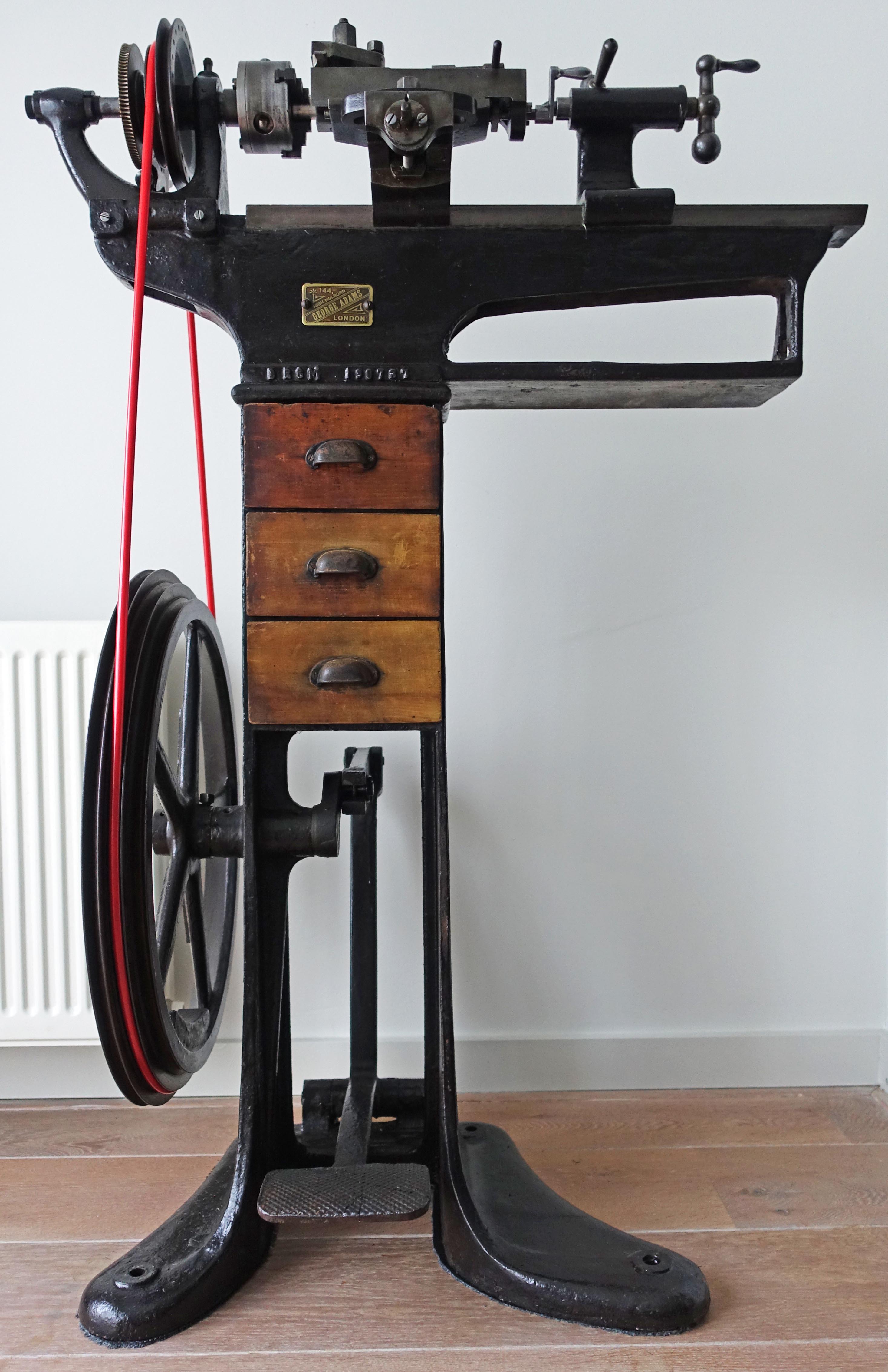

Many lathes have been mounted on single-post, treadle-drive stands; however, these were heavier machines with examples including the Pittler "Trumpet Stand" mounted Model B2 from the 1920s, the 1881 Weisser, and the Ehrlich - all also shown below.
Another form of 'single-tube' stand, the Pittler Model B2
