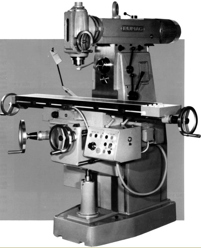

Rumag Series 1
Types: REE-1, RU-1, REEV-1, RU-1-VG and REE-1-VG
Built in five versions - the horizontal REE-1, universal RU-1, vertical REEV-1, ram-head vertical/horizontal REE-VG and ram-head horizontal-vertical-universal RU-1-VG - Rumag Series 1 millers were, in reality, just one basic type suitably modified in specification for a particular application. This approach allowed the fitting of many common parts and hence economy of production and wide interchangeably of accessories.
Both horizontal and vertical spindles could be ordered with ISA 30 or 40 fittings or even a No. 3 or No. 4 Morse. Two drive options were offered, "A" and "B", The "A" system used a 3 (optionally 4) kW motor driving a 6-speed column-mounted gearbox that in turn connected to a high-low range box. The final drive gear of the second box was on the spindle itself (and of large diameter and weight to provide a flywheel effect) and positioned immediately behind the front double-row, high precision cylindrical roller bearing. Fitted with a 1400 r.p.m. motor speeds spanned 36 to 1400 r.p.m. and with the optional 2800 r.p.m. unit from 71 to 2800 r.p.m. Electrical switchgear and controls - for spindle and table drives - were neatly contained in a separate box to the right-hand side of the knee.
Less expensive, the "B" drive employed a 2-speed 1400/2800 r.p.m. motor with a 3-step V-pulley on its spindle driving to the same high-low range box used on the "A" drive. Thus equipped this machine had 24 speeds from 36 to 2800 r.p.m. As ever, Rumag were happy to oblige their customers and could also supply, at extra cost, the "A" drive with a 2-speed motor to give the same twenty-four speeds.
On the vertical miller the same drive system was used but with the drive to the swivelling head (clamped in place with four bolts) turned through 90° by fine-lapped, spiral-toothed Klingeinberg-Palloid bevel gears. On both types twelve speeds were provided ranging from 25 to 1000 r.p.m. with a 1400 r.p.m. motor and twice as fast with the 2800 r.p.m. option. The independently powered ram-head was fitted with a 3-speed 700/1400/2800 r.pm. motor and had nine speeds from 80 to 2800 r.p.m. All gears and shafts in the drive systems were manufactured from high-quality materials, hardened and ground and ran in precision roller races. Simple but reliable oil bath lubrication was provided with inspection windows to check the level.
As an accessory for the horizontal models the Type VK self-motorised, high-speed vertical head was offered. This had a lever-action, 75 mm travel quill and six speeds of 1000, 1600, 2000, 2500, 3150 and 5000 r.p.m. (or optionally, 125, 250, 500, 1000, 2000 and 4000 r.p.m.), and was thus able to tackle a wide range of jobs from fly-cutting to the use of small milling cutters and co-ordinate drilling.
Each model was available with a choice of three 250 mm wide tables - 800, 1000 or 1250 mm (all with three 16 mm wide T slots on 50 mm spacing) with longitudinal travels of, respectively, 500, 700 and 800 mm by hand or under power. However, if the handles were removed each travel was increased by 100 mm. Cross travel, at 205 mm, was the same on all models, as was vertical (at 500 mm) on all but the REEV-1 vertical (where it was reduced to 460 mm). Power feeds in all directions were driven by a variable-speed, externally mounted DC motor that gave rates from 20 to 2000 mm/min - the fastest of which also doubled as a "rapid". For safety, the table and knee handwheels were arranged to disengage automatically when power feeds were engaged. Control of feed rate was by a dial with selection of direction by push-buttons and stop by either hand or adjustable trip dogs.
As an option, a simple form of programme control was offered; similar to that fitted to the smaller Rumag machines this gave a rapid forward motion, the appropriate feed rate and a rapid return. Start could be from the left or the right - and it was possible to include in the system a number of automatic, power-driven rotary tables and dividing heads..
