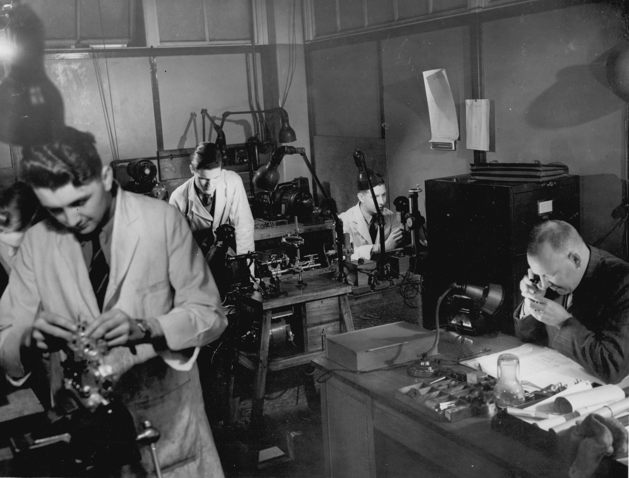

16th April, 1943 and a young Mr Hudson works at a bench in the foreground. Sitting at the desk is Mr. W.H.R. Clay ("CY"), designer of the first R-R lathe. The watchmaker's lathe in the middle of the photograph looks to be a pre-war Lorch
