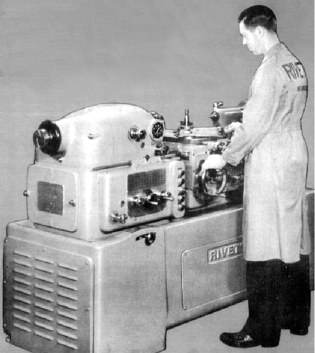

Introduced during WW2, the 121/2" x 20" Rivett 1020 was, after a short production run,  withdrawn from sale being replaced first by the rare 1020R and then the more common 1020S (20 inches between centres) and 1030S (30 inches between centres. The designer of 1020S is believed to have been Italian and the first batch of lathes was assembled and tested by Leon E. Levasseuring. The lathes, built from 1949 to 1961 and known as the Steelway Precision Toolroom Lathe, were aimed at the same market segment as the (then) class leader, the superb Monarch Model 10EE - and so, unsurprisingly, resembled that model in their appearance. As was common at the time to many other makers, the lathe was also offered as a "manufacturing" or "production" type, the 1020M, this version lacking the (expensive) leadscrew and probably equipped with a different speed range. Superbly made, the toolroom versions boasted a comprehensive specification with a 12.75" wide bed, fitted with hardened steel ways, and enormously long saddle wings that gave a contact area of 55.5 square inches.  Weighing around 3900 lbs (1.6 tons) and 4200 lbs (1.875 tons) respectively  the lathes sat on a substantial cabinet stand of cast iron and held a cushion-mounted drive system that formed a complete unit and that could be maintained through large openings in the end and the back of the stand - or withdrawn completely through an end door.
Drive was by a 5 h.p. 3-phase 1750 r.p.m electric motor carried an expanding and contracting pulley, the opening and closing of which was activated by a small motor controlled by push buttons, marked
Fast and Slow, positioned to the right of the screwcutting gearbox, that gave two variable-speed ranges. The drive from the motor passed to a shaft carrying a dog-clutch arrangement that allowed the motion to continue either to its end - and so drive a triple V-belt connected to the backgear assembly in the headstock - or to be passed across to a parallel countershaft that directed the drive, via a 3-step V-belt, straight to the end of the headstock spindle. The lower backgear ratio was 12.5 : 1 and gave speeds from 22 to 200 rpm while the higher ratio was 6.25 : 1 with speeds from 44 to 400 rpm. This arrangement ensured that the V-belts did not lose their efficiency, their running speed never falling below 300 feet per minute. Thanks to Tom Hammond and his dedicated Rivett web site, we know now that two other versions of the lathes were built, these being the 1020F and 1030F and constructed during the Rivett Company's final years when a subsidiary of Leland-Gifford Co. The centre height of the "F" was increased to give a swing of 13.5 inches and the tachometer changed from a mechanical to electronic type.

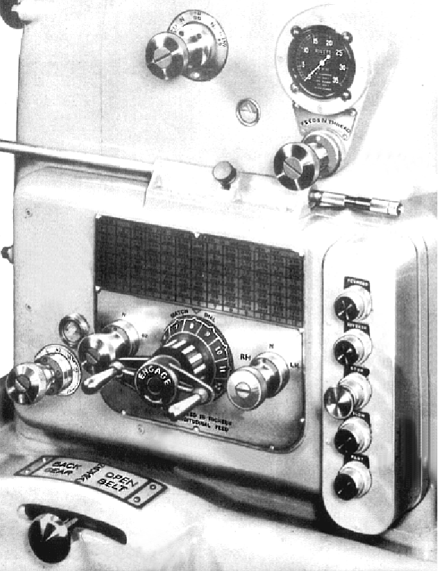

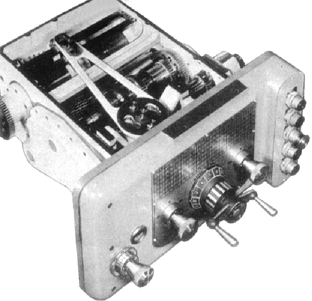

Like that used on the Monarch 10EE Toolroom lathe, the screwcutting gearbox used selector knobs on each side of a central turn-push-pull selector. The box, built as a complete, independent unit, could be slid out of its housing in the bottom section of the headstock for servicing or repair. The unit contained an oil sump, fitted with a sight-glass level indicator, from which the gears and bearing were lubricated by splash whilst the idler gears, on the external drive, ran in grease sealed bearings. All the gears associated with the box were manufactured from heat-treated alloy steel - and either ground or shaved according to their particular function - whilst the shafts carrying the sliding gears were of the six-tooth involute splined type. A total of 72 rates of feed and 84 threads were available including, so the makers claimed,
" …every world standard from 2 to 240 t.p.i." The actual range was: 2,  21/4,  23/8,  21/2,  23/4,  27/8,  3,  31/8,  31/4,  33/8,  31/2,  33/4,  4,  41/2,  43/4,  5,  51/2,  53/4,  6,  61/4,  61/2,  63/4,  7,  71/2,  8,  9,  91/2,  10,  11,  111/2,  12,  121/2,  13,  131/2,  14,  15,  16,  18,  19,  20,  22,  23,  24,  25,  26,  27,  28,  30,  32,  36,  38,  40,  44,  46,  48,  50,  52,  54,  56,  60,  64,  72,  76,  80,  88,  92,  96,  100,  104,  108,  112 and 1 20. In addition, by setting the lever under the rev. counter to "Feed" (which doubled the pitch of the previous twelve threads) the following pitches could be obtained: 128,  144, 152,  160,  176,  184,  192,  200,  208,  216,  224 and  240 t.p.i. A range of metric and other pitches could be obtained by employing different external pick-off gears on the drive from headstock to gearbox.

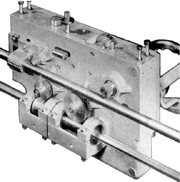

Bearing more than a passing resemblance in both appearance and function to that on the equally well-made Monarch 10EE toolroom lathe the carriage assembly of the Rivett 1020S was enormously heavy yet moved with silken smoothness along the bed. The leadscrew was reserved only for screwcutting with a powershaft providing a drive for the power sliding and surfacing feeds. Two separate, snap-up-and-down horizontal levers were used to select and engage the feeds with each working through safety overload-protected clutches. A precision carriage stop was fitted and arranged in two parts: a dial-test indicator, mounted on the left-hand edge of the saddle, engaged the rod of a micrometer held in a clamp on the lower face of the headstock - the combination of a positive stop, and a continuous, precision-reading of saddle travel being a most useful feature. The base of the double-walled apron contained an oil sump, with a sight-glass level indicator, from which lubricant was distributed to the bedways and all the apron gears, shafts and bearings by a plunger pump activated by the engagement of either feed. An interesting point (and one overlooked by many designers) was the attempt to minimise deflection by locating the carriage clamping bolt in the middle of the apron.

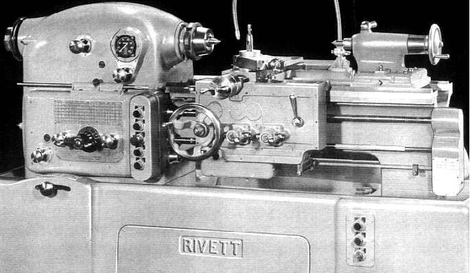

Rivett 1020S Toolroom Lathe
Massive build yet modest capacity made for a superbly accurate and potentially reliable machine with a long and productive life

The screwcutting gearbox was very like that used on the Monarch 10EE Toolroom lathe in both operation and the appearance of the knobs each side of the central turn-push-pull selector.

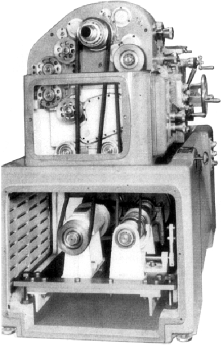

The two countershaft units in the base of the stand provided separate drives to the spindle and headstock backgears.  The drive from the variable speed unit passed to the right-hand unit and from there, via a dog clutch, either across to the left-hand unit (and up to the end of the spindle) or up to the lower of the two V-belt pulleys on the headstock - and hence into the backgear assembly.

The Rivett 1020S drive unit was cushion mounted, within the cabinet base, and formed a complete system which could be maintained through large openings in the end and the back of the bed - or withdrawn completely through the end door.
The electric motor carried an expanding and contracting pulley arrangement, the opening and closing of which was activated by a smaller motor controlled by push buttons, marked Fast and Slow, positioned to the right of the screwcutting gearbox. The drive then passed to a shaft carrying a dog-clutch arrangement which allowed the motion to continue either to its end - and so drive a triple V belt connected to the backgear assembly in the headstock - or to be passed across to a parallel countershaft which directed the drive straight to the end of the headstock spindle.

Inside face of the double-wall, oil bath apron showing the two separate take-offs on the power shaft  for power sliding and surfacing
A model of simplicity and ease of use. Power sliding and surfacing feeds were each selected and engaged by their own lever and worked through safety overload clutches.

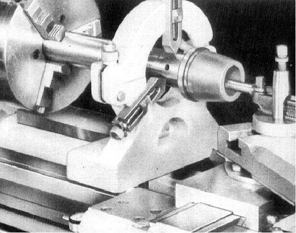

Follower Rest or "Travelling Steady" - capacity 2" in diameter.
