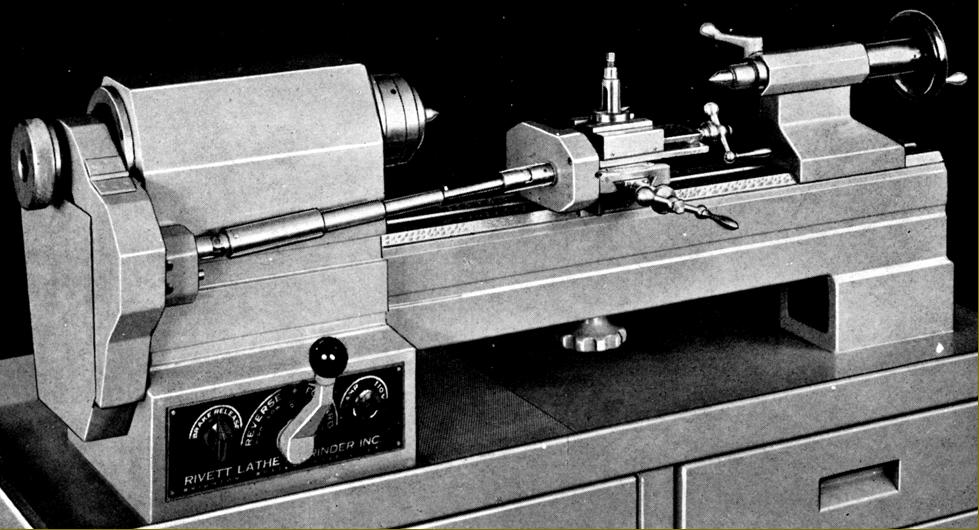

Basic Rivett 918 - bed, electrical controls, headstock, collet draw tube, catchplate, tailstock and clamp assembly to mount bed fixtures

Rivett 918 precision plain-turning bench lathe

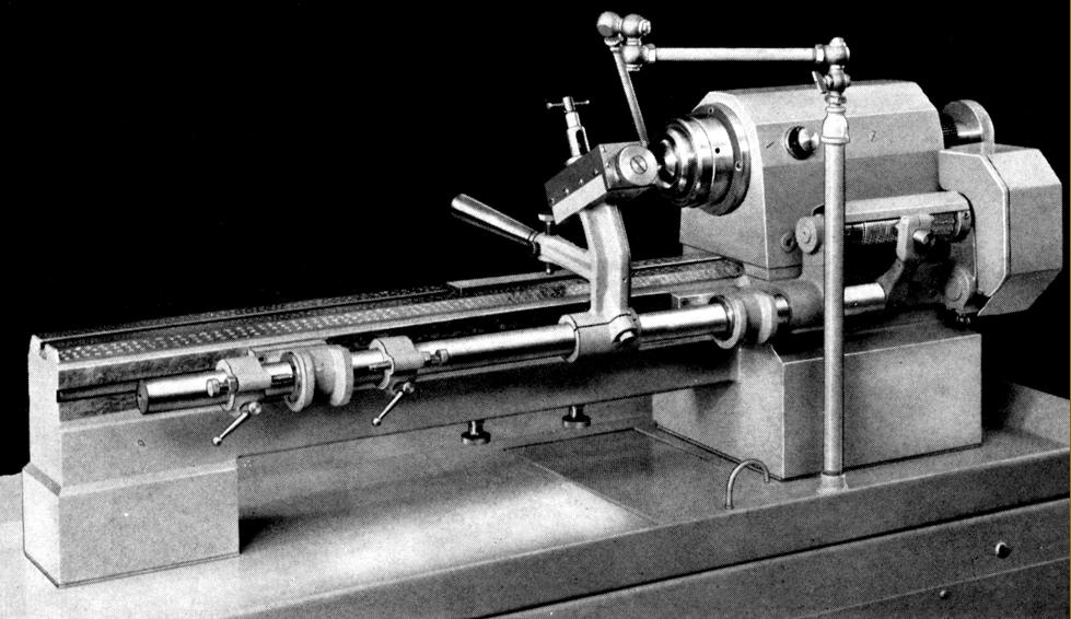

Rivett 918 arranged as a hand-screw (capstan) lathe

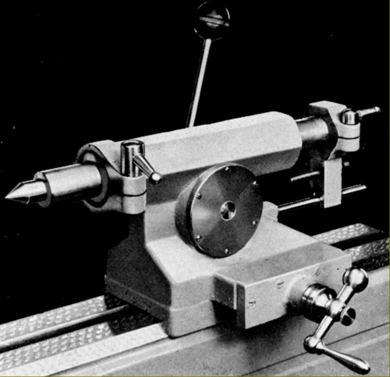

Cross slide lever-operated tailstock. This unit combined the action of a normal lever tailstock with 2.5-inches of cross feed and was intended for recessing, circular grooving, facing and slotting. On this model the spindle's 3.25-inches of travel was driven through rack-and-pinion gearing

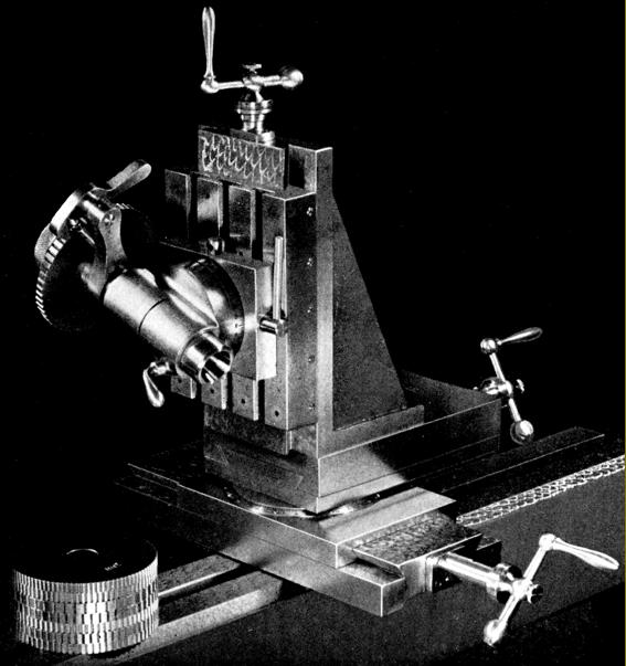

An unusual design of milling attachment, almost certainly unique to Rivett, bolted to the bed in place of the compound slide rest. The unit consisted of consisted of a baseplate that clamped to the bed on top of which was a screw-controlled longitudinal slide able to be moved through 1.125" and swivelled through 360°. Mounted on the base and arranged vertically was a casting shaped to accept the ordinary compound slide rest (and indeed, other bed-mount fittings). This arrangement gave the assembly a wonderfully varied number of movements with its usefulness further increased by the availability of a large T-slotted table, an angle plate and machine vice.
