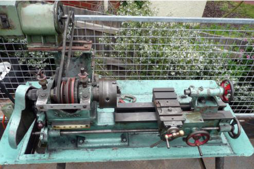

Rexman lathes were made, in some numbers, in the immediate post-WW2 years in Melbourne, Australia. The Company was owned by Rex Osman (hence Rex-Man) who made his 4.5 inch centre height machine available in various bed lengths. The machine appears to have been very well built and finished and absolutely conventional in design and execution. Typical of the type made for amateurs in the period 1930 to the early 1950s, a flat-topped V-edged bed with a gap was used, the spindle bearings were in plain bronze, a slow-speed backgear was fitted on an eccentric engagement shaft and screwcutting was by changewheels. Drive to the spindle came from a robust countershaft bolted to the bench behind the headstock with final drive by a smooth-running flat-belt over a three-step cone pulley -  Useful fittings for this market included a proper compound slide rest (with the T-slotted cross slide equipped with a "step-out" bracket supporting the end of the feed screw and allowing an extra 1.5 or so inches of travel), tumble-reverse gearing to the leadscrew, a hollow tailstock spindle with a No. 2 Morse taper, an extension to the end of the leadscrew allowed a handle to be fitted and the thread-dial indicator was of a decent, easily-read size.
Mr. Osman was, apparently, amenable to supplying lathes to a customer's requirements and it is thought that a Norton-type quick change screwcutting and feeds gearbox may have been available as an extra.
