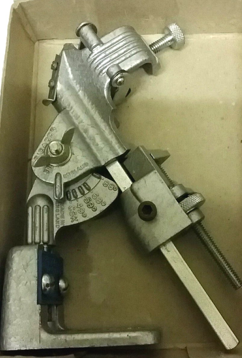

More recent models, from the late 1950s onwards, include the English-made Picador and two another very similar die-cast examples, currently sold in the UK as the "Draper" and "Spiralux" - the latter marketed for many years in the United States as the "General" and "Blue Point" (the latter a lower-cost branding of Snap-On). It is almost certain that the unit has also been sold, and continues to be available, in various unbranded or oddly-named forms. All the American types appear, apart from their price, to have been identical and are often discovered (as are other brands, in other countries) complete with their original box and in almost unused condition….
Although the "General", "Blue Point", "Picador", "Draper" and "Spiralux" all work (or fail to work) in exactly the same way as the older types, they looks almost toy-like in their construction and compare badly to the all-steel and well-engineered original. However, when employed skilfully - and with a full understanding of the principles involved - excellent results can be obtained, though it is all to easy to make a complete hash of the job and give up in despair.
A very experienced American user points out that:-
the angle of the pivot pin differed from model to model - some being aligned vertically while others were at an angle, the latter introduced as being un-adjustable and hence more suitable for the amateur market. With a vertical pin, the cutting edges of the drill require aligning at the "5 to 5 o'clock" position to produce the correct back-off angle, though by twisting the drill slightly this setting can be altered. With the pin at an angle the cutting edges need to be set vertically and so the back-off angle is, essentially, fixed; if the drill is subsequently twisted in its holder, unpredictable effects result, believed to do with the diameter of the drill being ground. In general, these devices seem to work better when used with a narrow cup wheel dressed flat. When employed as shown in the instructions (on the side of a normal grinding wheel) a hollow wear pattern is eventually formed that destroys accuracy.
An important tip is to set the angle and projection first, adjust the registration pointer and end-stop and then remove and replace the drill. If it goes in easily, sharpening can commence - if not, adjust as needed, take out - and try again. The "in-and-out" method  guarantees a symmetrical point because the drill insertion method is the same for both. However, adjusting, grinding and then turning over will tend to produce asymmetrical results.
