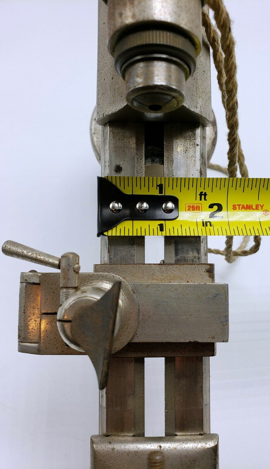

The great advantage of a Webster Whitcombe is that, with few exceptions, all are of identical dimensions with a 50 mm (1.968") centre-height (though very occasionally 65, 70 mm and other figures are found), a bed formed with a 37 mm-wide flat on the top, a 60-degree bevel along each edge and a headstock fitted with a spindle to accept 8, 10 mm or 12 mm collets (though odd, in-between sizes have also been discovered).

While numbers of older WW lathes lack any form of identification, recognition of a Reese is straightforward: the bed foot beneath the headstock is in the form of a plain cylinder, the handle to clamp the tool rest down a plain, 4-spoke capstan wheel, the word "Reese" in a unique, double-line font engraved on the end of the bed and the maker's name on the underside.
So far, no Reese has been found with a screw-feed compound slide rest assembly, only a flip-up T-rest so, if you have a Reese lathe, especially one in the maker/s box with accessories, or any sales literature, the writer would be delighted to hear from you..
