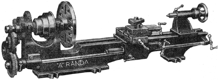

The Randa Type A and B backgeared, screwcutting lathes were both the same size but, whilst the A had a full compound slide rest, a T-slotted cross slide and a foot at the tailstock-end of the bed, the B was fitted with a simple non-swivelling top slide and a cantilever-form bed. The "B" badge shown cast into the bed in the picture above (and the "A" badge in that shown below) appear not to have been used on production lathes. The slide-feed screws had proper, square threads, but they ran direct in the castings, without benefit of replaceable bushes. A quick-traverse was fitted to the carriage drive, but not by the usual method of a rack and pinion drive. Instead, a steel worm wheel engaged against the top of the leadscrew and, just like the Myford ML10 which still uses the same system, included a direct-reading dial-thread indicator engraved on an inner ring next to the operating handle. Because the gearing of the carriage traverse was very high (turn the handle a little and the carriage moved a lot) the leadscrew was fitted with a balanced handle at its tailstock end so the operator could maintain a fine feed by hand. A simple, one-sided unit (without even a thrust plate to support it) the carriage to leadscrews "clasp" nut was fitted with a spring-loaded "snap-action" engagement lever. As an option (though it can rarely have been specified) a special apron was available fitted with a double clasp nut, running in adjustable V guides and operated by a lever turning the usual type of an eccentrically-slotted ring. Bored through 3/8" clear, and one-inch in diameter, the spindle carried nose of 1" x 12 t.p.i and the same No. 1 Morse taper as the tailstock. The three-step headstock flat-belt cone pulley had diameters of 3.75", 3", 2.25" and was 0.75 inches wide. The capacity in the gap was eight inches and the backgear, which was arranged in the simplest way possible with the bull wheel fitted to the left hand end of the spindle, had a ratio of 6 : 1. Each lathe was available with a capacity of twelve or twenty inches between centres and came complete with a set of ten changewheels for screwcutting, a 6.5" diameter faceplate, a 3.25" catchplate and a machined chuck backplate. Of very limited extent, the maker's accessories list contained just a 3-jaw chuck, a treadle (often described as a "foot motor" in contemporary literature) a countershaft for motorised drive and a complete stand with tray and countershaft drive installed. The latter, at £4 : 7 : 6, cost only two shillings and sixpence (251/2p) less than the lathe - whilst even the 3-jaw chuck represented an additional investment of some 38% of the basic price..

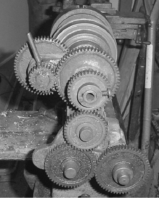

Readers who have tried it will know that setting up a fine-feed compound gear train on the L-shaped changewheel bracket is not the easiest of tasks. As this picture shows, top right, the slow-speed backgear assembly, here is how to make it work: 1) release the 3-step drive pulley and the gear fastened permanently to it from the spindle - this is done by removing a set-screw that goes through (probably) the middle pulley 2) using the lever, rotate the outboard gear cluster so that it engages with the pulley gear and large gear on the end of the spindle 4) modus operandi: the drive belt turns pulley and the little gear fastened to it; the little gear drive larger of the outboard cluster gears; the shaft carrying the larger cluster gear has a smaller gear on its other end that drives the large gear fastened to the outboard end of the spindle. 5) result: the spindle turns slowly
