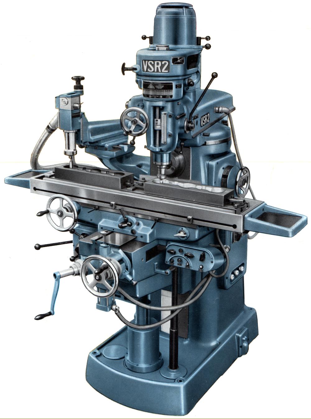

Types VR-2, VRG-2 and VSR-2
If the writer's reference source is complete, three sizes of table were available on these models: a 42" x 10" for the VR-2 only and a choice of 47.75 x 10", 47.75" x 11.75" and 55" x 11.75" for the other two - though for some years of production the longest was not listed. While the 10-inch wide tables had three 9/16" T-slots on 2.5" spacing, the 11.75-inch had four of the same size and disposition. Longitudinal travel on the two longer tables by hand or under power (hand being by a single, forwards facing handwheel working through bevel gears) was 35.5" but limited to 29.5" on the shortest. The single, forward-facing table control was an arrangement that operators used to table-end handle found strange at first acquaintance, but soon accepted as very convenient.
Hand-driven cross and vertical travels were identical on all versions at 11" and 16.75" respectively (power feed in these directions was not available). Driven by a 0.7 h.p. motor through an oil-bath gearbox located on the left-hand side of the knee, twelve rates of longitudinal table feed were available spanning 0.4375" to 19.625" per minute. Selection of feed rates was by a combination of a short lever and a front-facing dial on the motor-gearbox unit with engagement by a second, longer lever - pressing it down from its central (neutral) position engaged the feed (and started the spindle) while lifting it up (against spring pressure) caused the rapid feed, at a rate of either 80 or (depending upon the year of manufacture) 100" per minute, to engage. All versions could be fitted, at extra cost, with a self-contained rapid vertical feed - but this was not available for the other feed directions.
Table feed screws were hardened and ground with that for the longitudinal drive running in an oil bath and made in two short sections, left and right and spring loaded against each other. The screws, around 3" in diameter, engaged against a long, semi-circular nut (a helicoidal rack) fastened to the underside of the table - this ingenious and beautifully constructed arrangement (adjustable to eliminate backlash) giving a huge surface area to slow down the rate of wear. Of conventional design, the cross-feed screw ran through two opposed bronze nuts, this arrangement also being adjustable to eliminate play. Lubrication of the table and knee ways was by a hand-operated single-shot oil pump positioned to the right of the saddle.

Types VR-2, VRG-2 and VSR-2 continued:
Fitted on the end of a ram having 16" of travel driven by rack-and-pinion gearing, the vertical head (with its main casting in Meehanite iron) could be swivelled through 90° each side of vertical by a crank handle working through worm-and-wheel gearing. It was locked to the ram not by the usual four bolts, but by a split ring formed with a conical periphery - the vertical position being obtained by a tapered pin of hardened and ground steel fitted at the 3 o'clock position on the head's right-hand side. Apart from the basic VR2, with a maximum clearance between spindle nose and table of 18 inches, all other models had 20", less, of course, the length of the collet chuck or cutter being used.
Normally driven by a 2-speed, 2 h.p./3 h.p. 1450/2800 r.p.m. motor, sixteen spindle speeds were provided from 65 to 4750 r.p.m. - the high range being by an A-section V-belt running over a 4-step pulley and the low range through a lathe-like backgear using hardened and ground gears. However, an alternative specification was also offered of a single-speed motor and eight speeds with a maximum of 2750 r.p.m., the difference being accounted for by the design of  spindle assembly - the high-speed version running in non-adjustable, high-precision SKF ball races the lower-speed type (more robust and intended for faster rates of metal removal) using adjustable Timken taper roller bearings. A manual spindle brake and screw-in lock (operated by a T-shaped handle on the left-hand front of the head) was fitted as part of the standard equipment (to enable the collet draw-bar to be tightened or released) with an electromagnetic brake offered as an option - a red push-button control bringing the spindle to a halt and holding it locked.
Hardened and ground (with precision-ground helical rack teeth) the quill held a nickel-chrome spindle (also hardened and ground) that could be moved through its 5" of travel by a quick-action lever for drilling, a handwheel through worm-and-wheel gearing for fine feeds or a choice of three rates of power up and down feed of 0.015", 0.003" and 0.006" per minute. Feeds could be disengaged by either the control handle or set to release automatically (to within a setting of 0.001") when the slide block fitted to the front mounted vertical ruler and micrometer-dial assembly contacted the top or bottom of its housing. To protect against overload a slipping clutch was fitted to the power feed, the disengagement load being adjustable by the operator. On the first models produced it is thought that the vertical spindle fitting was an American Standard (ASME), later changed (to allow easier access to common tooling and collet chucks), to a Bridgeport-type R8 spindle or, optionally on machines from the early 1960s, an N30. Other fittings listed over the years included the IS030, ISA30 and ISA40 - and it is likely that for different market areas alternatives would also have been offered. On the VSR horizontal spindle models a similar mixture was offered, but less the inadequate (for horizontal milling) R8.
Lubrication of the entire head - bearings and gears - was by the daily introduction of a small quantity of oil through a filler at the top of the assembly, this having to be drained every few days through a plug at the bottom of the housing.

Rambaudi VSR-2 combination vertical and horizontal fitted with hydraulic copy equipment
