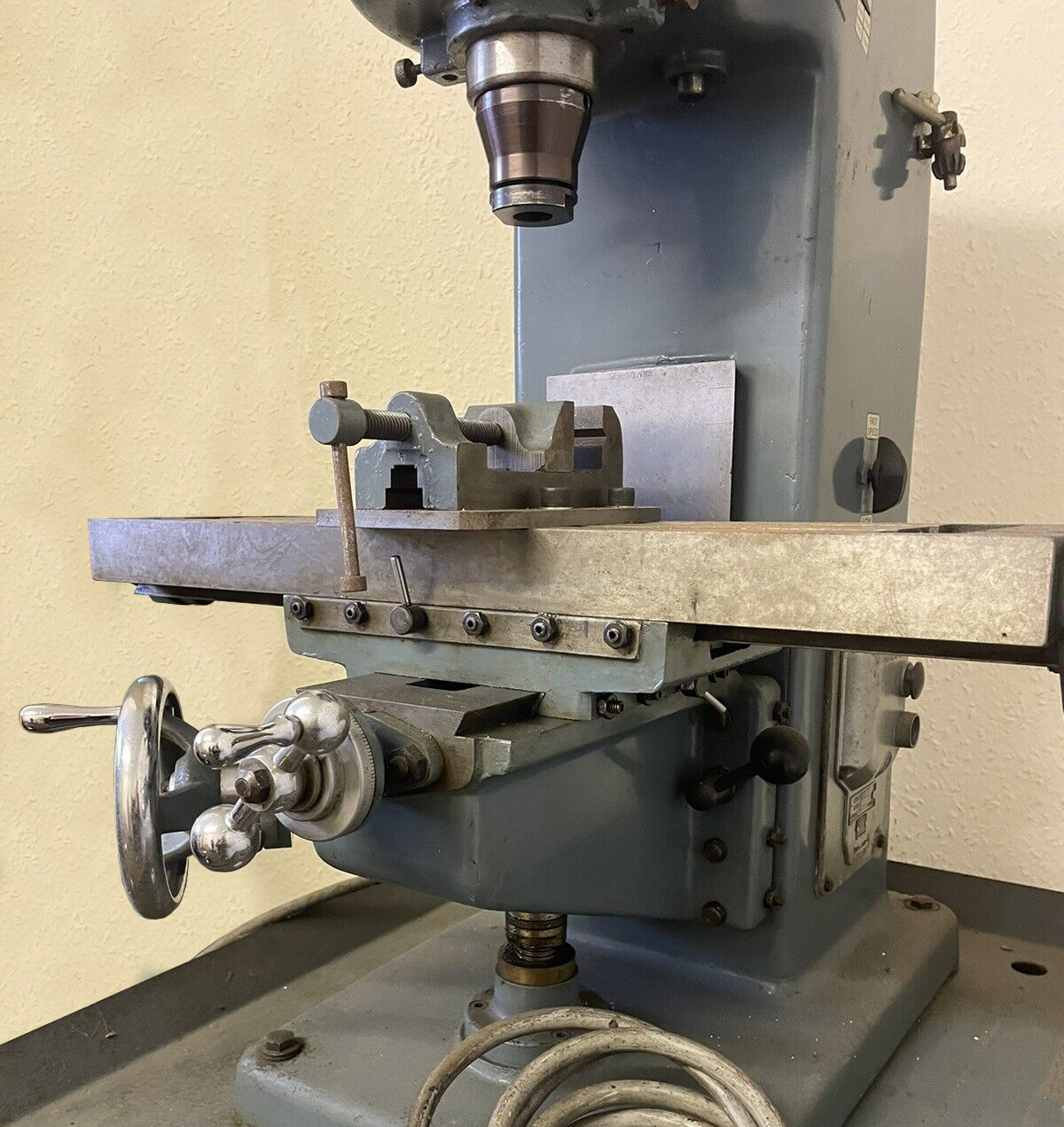

Built from the late 1950s until the late 1960s, the Raglan vertical miller was an especially well-made, beautifully finished and compact machine. It was usually supplied on the maker's braced sheet-steel cabinet stand (with a shallow, welded-on chip tray) that required a floor space of around 24" x 18". The motor, either a single or 3-phase 1425 r.p.m., or 2-speed 710-1425 r.p.m. 3-phase unit, was built into the body of the machine and drove the spindle though a variable-speed system of a type also used on the Company's "Little John" lathes. A push-button starter was built, rather out of easy reach, into the right-hand face of the main column. Spindle speeds ranged from 380 to 2250 with the 1-speed motor and 180 to 2250 rpm with the 2-speed.
Running in Timken taper roller bearings, the high carbon steel spindle had a No. 2 Morse taper in its nose - but no down feed, instead the knee, as on a proper, full-sized machine, could be elevated.
While early versions of the standard 21" x 5.5" table had just two T-slots, later models had three with a coolant trough formed at each end. Unusually, only the top part of the T-slot goes the full length of the bed, the full "T-slot" shape beings confined to that section between the end coolant troughs. One must assume that the first stage of cutting the T-slots would have been done on a horizontal miller - where it was easier to cut the full table length - but the designer (or machinist) must have thought the user would only ever need full-form T-slots along the "working area". Both square and Acme-form feed screws appear to have been used during the production cycle, running through the same design of bronze nut as used on the Raglan "Five-inch" lathe. The Company's usually large and clear friction-setting micrometer dials finished in satin-chrome were fitted - though unfortunately only one (rather fine, chrome-plated) handwheel was provided for the longitudinal feed, at the right-hand end of the table. The table travel was 12" longitudinally, 4" in traverse and around 8.5 inches vertically - the latter figure also being the maximum clearance between spindle nose and table. Rather lighter than it looked, the miller weighed just 140 kg  - caused in part by the main column being in cast aluminium, an unusual choice for a miller, but in this case completely effective.

A remarkably original and fine  Raglan miller--even to the maker's stickers
