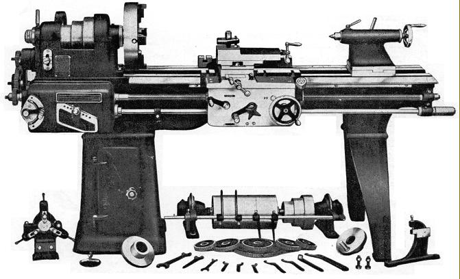

The firm making Purcell lathes was owned by a Mr. William Crooks who, having bought the Purcell Engineering Company in 1940 (Purcell Engineering Co. (1940) Pty. Ltd.) then expanded the range - previously marketed using various names including "Vanguard" - to include smaller lathes and other machine tools. In addition to a copy of the South Bend 9-inch, the company also made a wide range of other lathes of various sizes - and information about these is sought. Production of Purcell lathes ceased around 1960. However, the start of the Company was in the early 1920s, with their first offering a general workshop and light-duty production machine, the "Visby", made in a wide range of capacities. By the late 1930s the original lathe had been updated, as the 8-inch New Visby and, in this form, proved to be a popular, long-lived model with both Mk. 1 and Mk. 2 versions stretching production into the 1950s. Both had "rounded" styling with the Mk, 1 being fitted with a flat-belt final drive from an underdrive countershaft and the Mk. 2 (with only minor alterations) available with the option of an all-geared headstock. In addition, a "heavy-duty" 8.5-inch version of the latter was also manufactured, the main differences being concentrated in an apron equipped with revised and much safer controls. As an addition to their line at some point in the late 1930s, Purcell introduced the heavier 8.5-inch Conemaster and otherwise identical but geared-head Record. By the late 1950s a thoroughly updated and quite different Mk. 3 New Visby was on offer - a machine with very much more modern, angular lines - and sold as both the "Record" 17/26 11" and "New Visby" 17/26 111. A popular smaller lathe was the company's direct copy of the American South Bend 9-inch, though in Australia this was in competition with two other clones, the Hercus and Sheraton. A prolific manufacturer, Purcell also undertook the building of various special-purpose machines including railway wheel-turning, long-hole-boring and facing lathes For its time the original Visby was an utterly conventional lathe and resembled, in some regards, the popular German Ehrlich sold in the United Kingdom as the IXL. Initially the name covered a wide range lathes varying in centre height from a smallest of 6" though 6.5", 7", 8", 9", 10", 11.5", 13", 14.5" and 16". However, it appears that production was eventually concentrated on two models, both of nearly identical mechanical specification save for their capacity in the gap, centre height (one being seven inches and the other eight) and diameters and width of their 3-step headstock cone pulleys. By combining the (helical) backgears with the maker's standard two-speed countershaft (200 and 260 r.p.m on the smaller lathe and 180 and 230 r.p.m. on the larger) six spindle speeds were available. With 1.75-inch wide headstock pulleys varying in diameter from 4 to 6.75 inches, the smaller lathe, using a 1 h.p. motor, had speeds from 23 to 297 r.p.m. whilst the larger, with 2-inch wide pulleys from 4.5 to 7.5 inches in diameter and a 1.5 h.p. motor, could run from 26 to 330 r.p.m. Continued below:
The original Visby lathe as advertised during the early 1920s

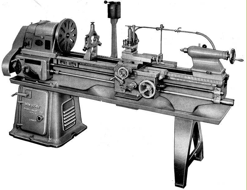

Continued: Introduced at an uncertain date, but most likely in the very late 1930s, the New Visby was a modification of the original fitted with an integral drive system. This, as on South Bend lathes of the same class, was totally enclosed within the headstock-end plinth. However, the main dimensions, mechanical design and detailing remained much the same as before - though guarding of gears and belts was improved and just one length of bed offered - with a capacity of 49 inches between centres. In summary the specification of the new models was: a 10.25-inch wide bed with an 11.5" centre height into the gap (with the ability to turn a disc some 7 inches thick on the standard 14-inch faceplate); a spindle bore of 1.5625", a Norton-type screwcutting and feeds gearbox able to generate 36 inch pitches from 4 to 60 t.p.i. and 26 metric from 0.25 to 7.5 mm, sliding feeds (from a separate key-way type feed shaft) varying between 0.001" and 0.0295" and surfacing from 0.000375" to 0.015" - all per revolution of the spindle - and a 4 t.p.i. leadscrew. Although now fitted with a neat, compact and efficient integrated drive system that gave six speeds of 21, 52, 94, 144, 240 and 420 r.p.m.- and retaining its 2-inch wide flat leather belt for final drive to the spindle - it was still possible to specify the lathe for drive by a separate countershaft, or from line shafting in a factory. However, the new arrangement ensured that the lathe met the competition head on for no longer was it necessary to spend a day installing an unwieldy wall or ceiling-mounted countershaft and motor assembly, belt strikers and motor platform, instead the lathe could be plugged in and used immediately. Mounted within the headstock-end plinth, the drive system was carried on a large cast-iron plate, the motor - either 1 to 2 h.p. - being slung beneath and driving a ball-bearing countershaft above by multiple V-belts. The mounting plate was in two parts, one being arranged so that the V-belts could be tensioned (and the setting locked) and the whole assembly hinged so that an externally mounted lever, closely resembling the type used on South Bend lathes, could be used to raise and lower the assembly when a change of speed was required. Fastened to the left-hand face of the saddle was a long aluminium cover that protected the front V from the wearing effect of swarf - and it's possible that some examples would also have been fitted with a similar over the back V. Certainly by the time of the Mk. 3 New Visby, in the late 1950s, all four saddle wings were thus equipped. The compound slide rest was unaltered, save for larger micrometer dials and rather inelegant, full-circle handwheels. Continued below:
Purcell New Visby Mk. 2 with flat-belt drive

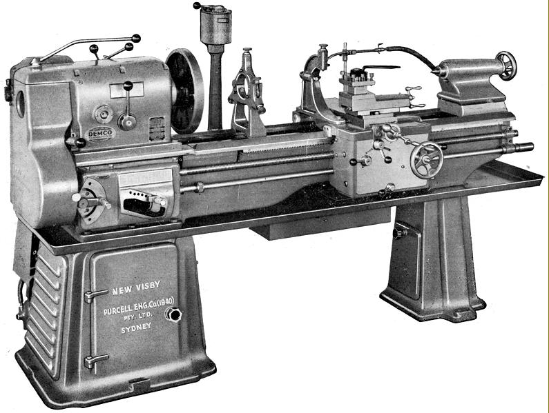

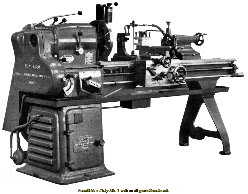

Continued: Although precise dates are unknown, it is likely that the New Visby Mk. 2 was introduced just after WW2 in 1947 or 1948. Changes to the belt-drive model were few - though the model was instantly recognisable by the use of a much heavier tailstock, with its barrel housing leaning forwards to improve the minimum centre-to-centre distance, a countershaft lifting lever hinged from top left-hand corner of the plinth door (instead of the main casting) and a reversing switch mounted on a tall post that bolted to the back of the bed. However, the main difference was the option of an all-geared, 8-speed clutched headstock with a 1.875-inch bore spindle and identical in general layout to that used on the company's contemporary 8-inch Record lathe based on the 8.5-inch Conemaster. Driven first by a 1.5 and then a 2 h.p., 960 r.p.m. motor fastened to vertically-adjustable rails on the back of the headstock plinth, speeds ran from a low of 30 to an inadequate maximum of 340 r.p.m. and - unlike the Record- there was no option to fit a 2-speed motor to improve matters..
Purcell New Visby Mk. 2 with an all-geared headstock
Rear view of the Purcell New Visby Mk. 2 with all-geared headstock
