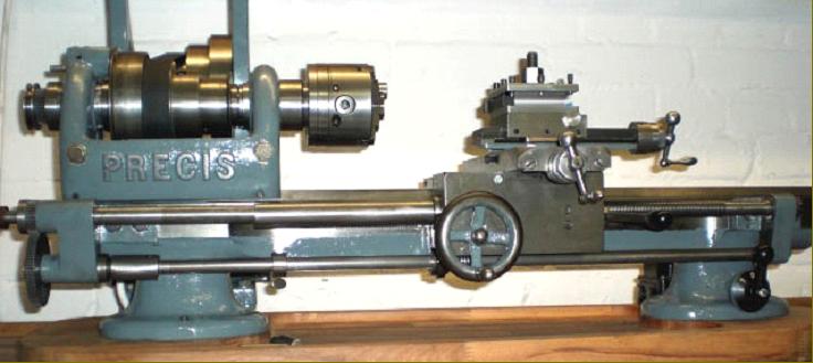

Precis precision screwcutting lathe
This Precis, a beautifully made geared-head model from the 1950s, exhibited an unusual combination of precision bench and engine lathe design together with a number of very interesting mechanical details. Like some French cars of the same period - that can only be described as "individual" - the designers of the Precis were not afraid to take their own course and make their own decisions . While the centre height of 100 mm was normal for the type, the massive headstock and tailstock used up most of the bed to leave a capacity between centres of just 400 mm. The bed, mounted on large, round feet, was the kind normally found on plain-turning, precision-lathes with a flat top and bevelled sides where the compound slide rest would normally have been bolted in position and the top slide used to take a cut. However, on the Precis, the carriage was adapted to power and screwcutting feeds, with a longer-then-usual saddle and narrow keeper plates running beneath the ways. Both these features - the bevelled-edged bed and round feet - appear to have been a Precis "trademark" feature with taper-turning fitted as standard. The headstock, despite its considerable bulk, had the spindle emerging from a long boss (which cannot have helped rigidity) and both dial and plunger controls on its front face. Power was fed to the apron through a conventional leadscrew and also by a long rod with just its right-hand section threaded. The function of this was rather clever - it reproduced a section of the (very low-set) leadscrew and so to helped to reduce the number of gears that would otherwise have been needed on the shaft of the thread-dial indicator to cover a wide range of metric pitches. Even the top slide, with its built-in 4-way toolpost, and a huge thread-dial indicator were of novel construction..

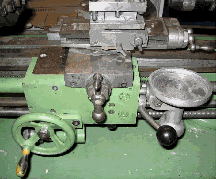

Quite possibly the world's largest thread-dial indicator - though in this case missing the index plate
The standard-fit 4-way toolpost was of massive construction and exemplary rigidity
The tailstock barrel was moved by rack-and-pinion with the operating handle protruding vertically from the rear of the casting
A taper-turning unit was fitted as standard
An earlier model Precis with an "open" face to the front of the headstock. The older Precis lathes are known to have taken 20 mm collets identical to those used on Schaublin and Dixi machines: note the non-symmetrical "balanced" ball handles on the compound slide rest - true French individualism.

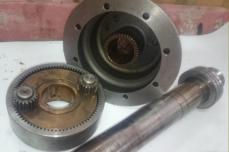

Precis headstock speed-reducing epicyclic "backgear" mechanism
