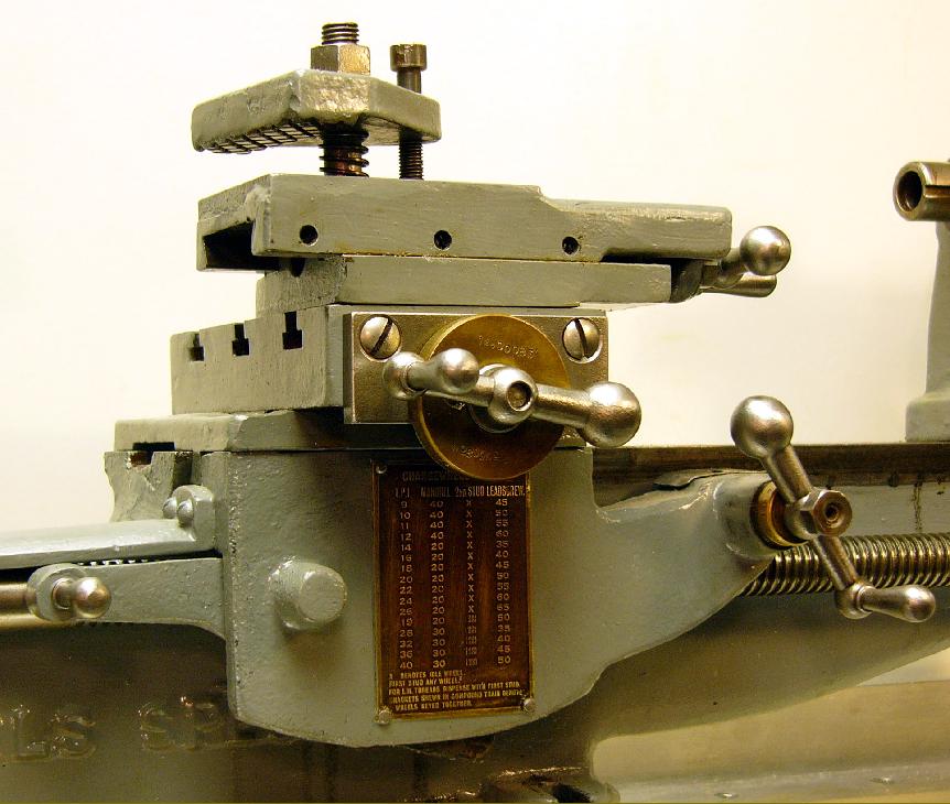

Later version 3-inch Pool Special with the pair of leadscrew clasp nuts operated by a snail-cam cam mechanism.
The first lathes had their single-sided leadscrew nut engaged by a snap-action lever
Last version: the "Pools 38 Special" with V-belt drive and backgear and changewheel guards
