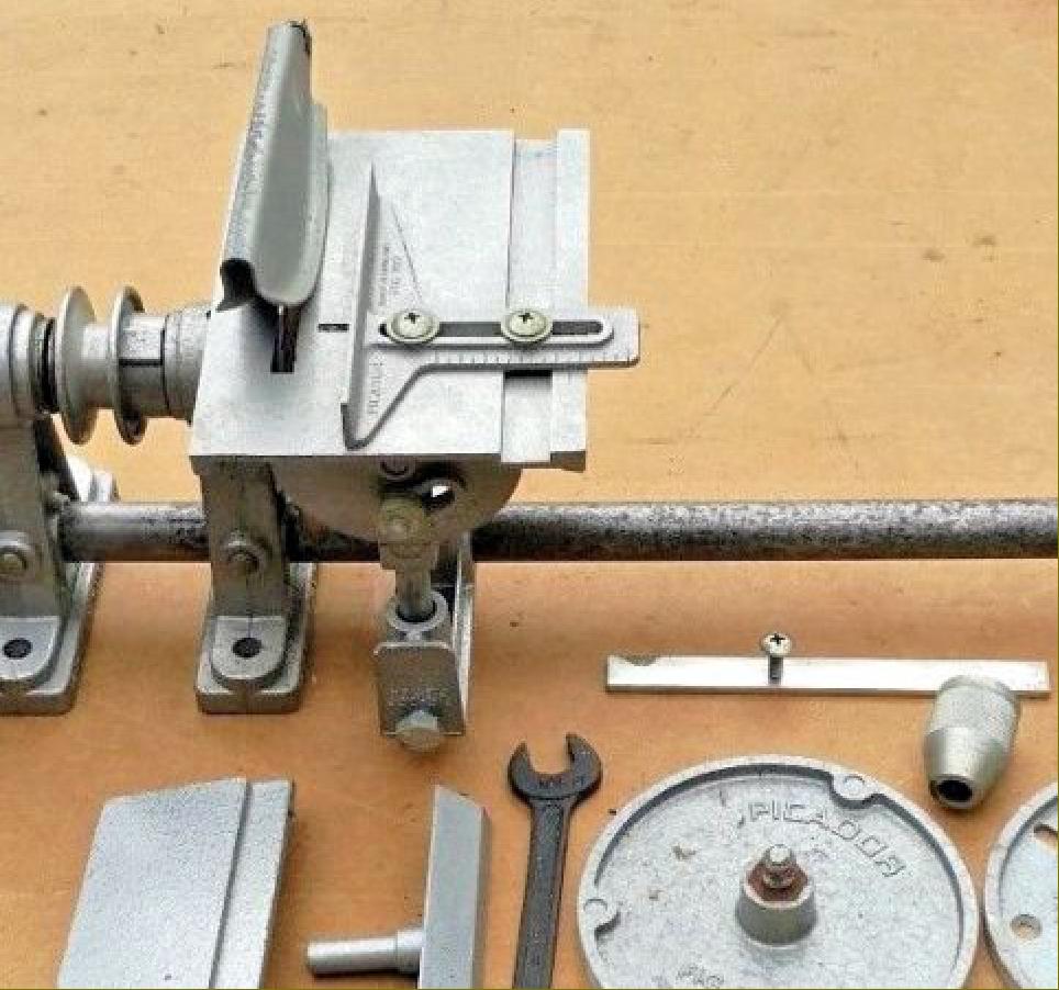

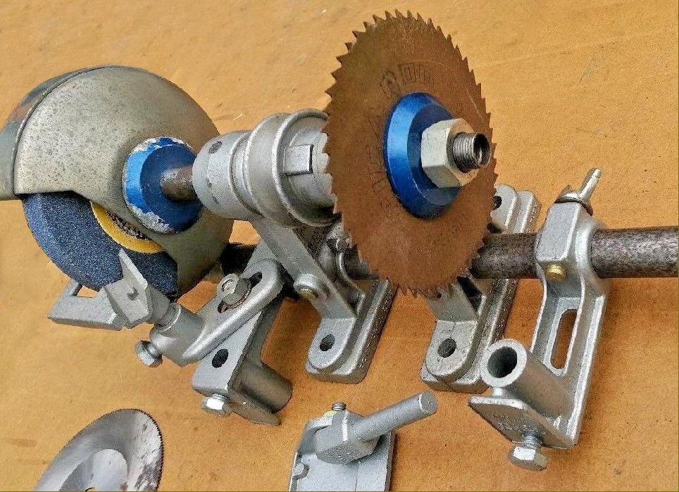

3/4" in diameter, the tube supplied was 24" long and passed through three supports that the makers referred to as "Tallboys" - these being held in place by cotter pins. Fitted with oil-retaining, graphite impregnated, powdered bronze bearings, two Tallboys acted as the headstock and held a 5/8" diameter ground steel spindle, its ends being machined with left and right-hand 1/2" x 24 t.p.i. threads and equipped with a proper ball thrust race. Fitted to the right-hand side was a small 3-jaw drill chuck - this end also being drilled and tapped 3/8" x 24 t.p.i. to accept a radially-slotted faceplate and a disc to which could be glued the supplied circles of sandpaper. Also amongst the equipment was a saw table that could be tilted through 45°, together with a 4-inch diameter blade. The table was properly equipped with a fence and saw guard, the latter, as usual, designed to open as the wood was fed in and close as it left.
On the left-hand end of the spindle was a guarded, 4-inch diameter Alumax grinding wheel and U-shaped tool rest, the latter with a V-groove set at 59° to face the side of the wheel - this being correct angle for sharpening twist drills.

Also in the kit was simple T-rest to support wood-turning tools, this being held in place on a "footstock", a casting bored to fit around the bed tube and resting at the front on right-angle foot. Later kits might have included a pair of wood-turning tools and a "motor rail", a simple hinged bracket that allowed the use of an ordinary foot-mounted motor in place of an electric drill.
