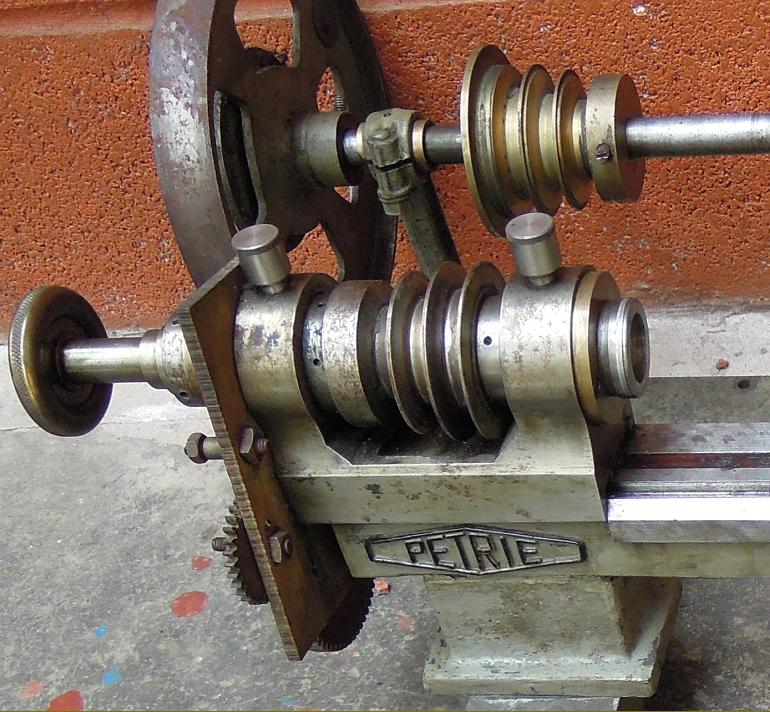

Based on a V and flat-way bed (not the easiest of designs for an amateur to tackle) the lathe had a headstock of elegant proportions with a large diameter spindle taking direct-fitting collets. As there was no thread on the end of the 1/4"-bore spindle chucks and faceplates were mounted on collets, so ensuring the absolute accuracy of their mounting. A 3-step V-pulley was fitted, with, rather oddly, little difference in their diameters and drive coming from a slender, bronze-bearing countershaft fastened to the back of the bed.  Drive from motor to countershaft was by a flat belt - a useful fitting when the "motor" might have been temporary, perhaps human-powered or derived in some was from a handy piece of machinery in a more remote location.

Although shown in its present state with changewheels mounted on a crude bracket, these are obviously not part of the original design,
