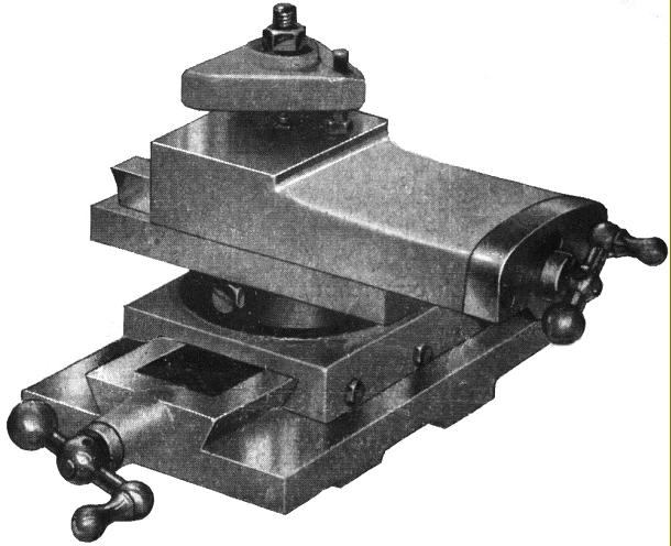

For metal and precision wood-turning jobs, a compound slide rest was offered; this had small, non-zeroing micrometer dials and a 360° swivel top slide of limited travel - instead of the much longer type normally fitted to plain lathes. With a useful No. 2 Morse taper, the 1" diameter tailstock spindle was bored clear though - to act as a long-hole boring support - and fitted with a square thread that passed though a large diameter but smooth-edge handwheel that lacked any form of handle to aid grip

Perhays compound  slide-rest assembly
