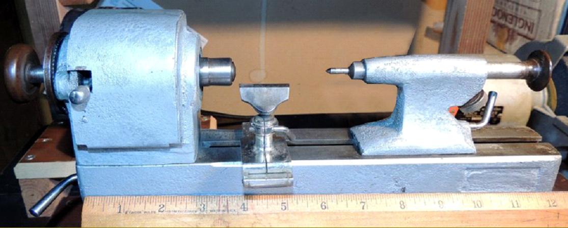

Two quite different versions of the tailstock have been found: one with rounded styling locked to the bed by an eccentric T-bolt controlled by a lever protruding from the end face of the casting and fitted with a simple "push" spindle; the other tailstock, with very rectangular lines, was held to the bed by a  direct-acting, screw-operated knurled nut nestling in a cut-out beneath the screw-driven spindle. The "push-type" spindle with its fixed centre (shown in the picture immediately below), was locked by a direct-acting screw with a large, knurled-head that impinged on it at an angle from beneath the casting at its right-hand end.

Pennant lathe with the "rounded" tailstock with a simple push spindle and locked to the bed by an eccentric T-bolt. The pulley indexing pin is missing on this example
