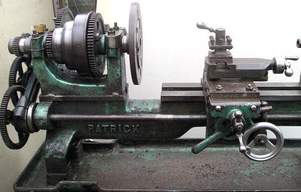

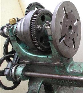

A rare survivor--a Patrick "Special" in original, unmodified condition

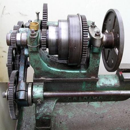

Extremely rare in this condition, a beautifuly original and unrestored 4 1/2" x 16" gap-bed screwcutting Patrick from the 1920s. This model is without backgear, an omission that, whilst it saved the original owner money, resulted in a compromised lathe that lacked versatility.

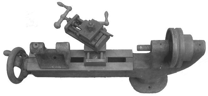

Treadle stand. Although small electric motors were widely available pre-WW2 they were expensive, often adding 25 to 40% to the cost of a new machine. One slightly cheaper option - and essential where there was no electricity supply - was the ubiquitous treadle drive.
Although of sound construction - and heavy build - the lathe was still built with an eye to economical production and penny-saving: no micrometer dials on the feed screws, only three gib strip adjustment screws

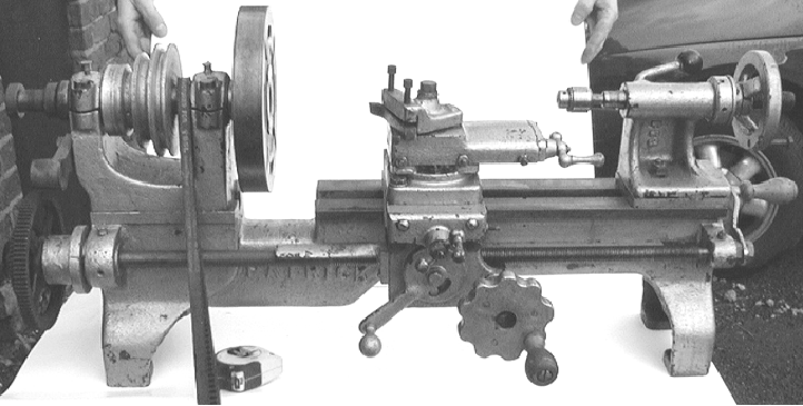

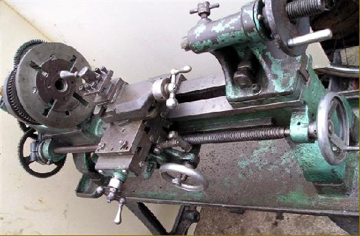

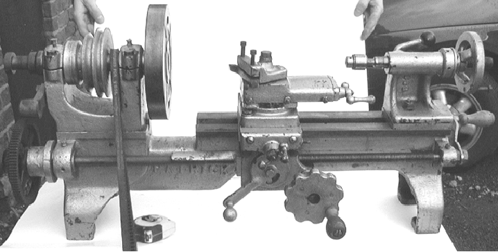

Almost certainly built in the late 1920s or early 1930s, and showing some improvements over the earlier model, this 4" x 16" gap-bed, backgeared Patrick has a headstock pulley to take inch-wide flat belt in place of a round-rope "gut drive", a more robust, rectangular-form apron with a geared drive direct onto the leadscrew and a heavier changewheel bracket. It has also been neatly adapted to carry a Boxford top slide--the carriage and leadscrew handwheels are also not original. Note the swing bracket on the changewheel drive to allow the insertion of an extra changewheel to generate left-hand threads.

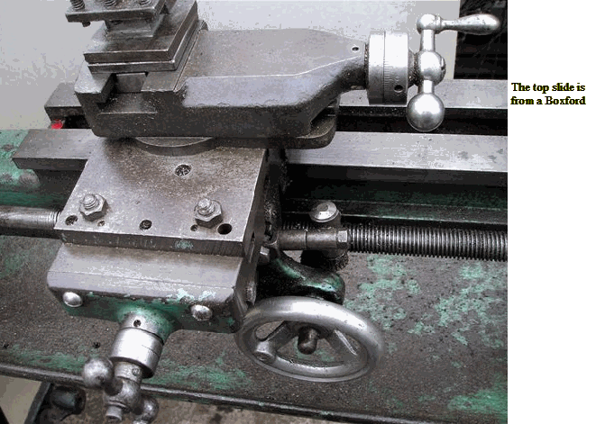

The top slide is from a Boxford
The Patrick illustrated above and below is not completely original, nor complete: the headstock pulley has been changed from one using three narrow Vees (to take a round-rope leather "gut drive) to a standard aluminium V-type to take a Z-section belt - though later Patrick lathes did use cast-iron flat and V-belt pulleys. The carriage handwheel may not be the maker's - and the screwcutting changewheels are not in place.

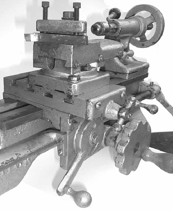

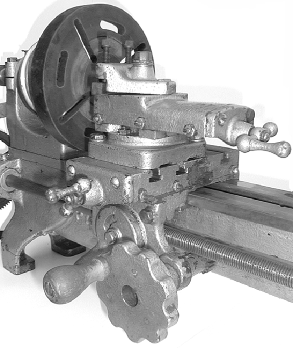

Because the lathe had a rather generous centre height for its overall dimensions, the makers had to indulge in some creative engineering to get the cutting tool up to centre height. Their interesting solution, instead of using just a thicker cross slide casting, was to mount the top slide on a (square-based) raiser block fitted with a circular T slot that allowed rotation through 360 degree. Note that the block under top slide is bolted down across one diagonal only.

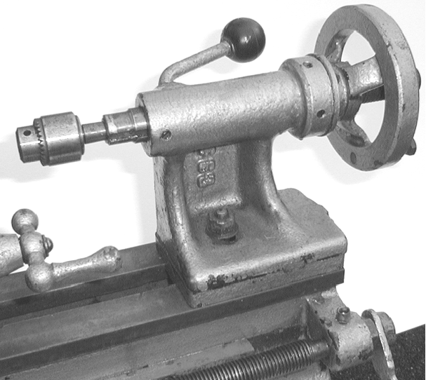

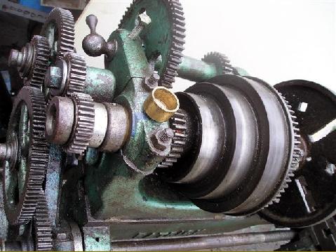

The tailstock barrel was threaded on its outer surface and passed through a threaded handwheel. The handwheel was retained by a two-part circular thrust washer located in a grove machined in the surface of its forward boss; an almost identical arrangement was employed for many years on the very popular Myford ML7
Rear view of the tailstock showing the circular, two-part barrel retaining washer and the simple - and horrible - screw-in barrel clamp.

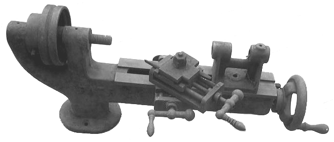

The square edge to the bed might mean easy production and a simple regrind - but the narrow, wingless saddle (only as wide as the cross slide) had a minimum bearing area against the rear shear and would have been both less stable under heavy cuts and likely to have promoted quicker wear than one designed along traditional lines.
