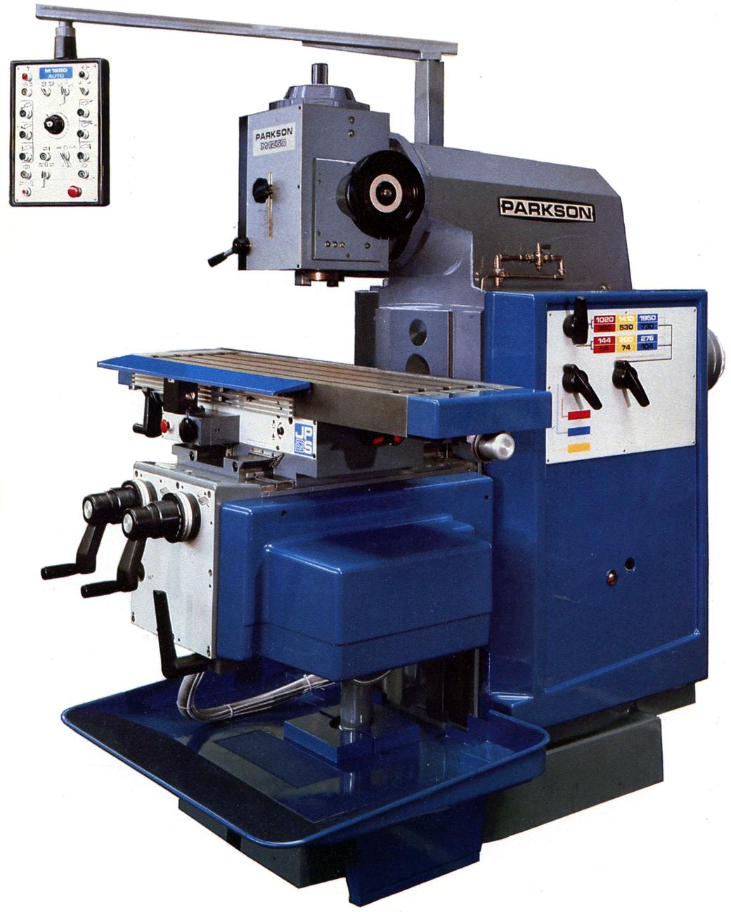

Parkson M1250 Milling Machines
Developed during the late 1970s for sale during the 1980s, the M1250 was a direct descendent of the M1200 with an almost identical layout and the same 7.5 h.p. main and 3 h.p. feed motors. Intended to span the market for conventional, hand-operated machines and a rapidly increasing need for CNC control, a number of different versions were offered, though all still followed the tradition of being based on Plain horizontal, Universal (with swing table) and Vertical types, the maker's designations being, respectively: M1250P, M1250U and M1250V. As on the M1200, models fitted with Auto Table Cycle control were available, this time indicated by the suffix 2 for models with this facility on table and knee and 3 for models that could have more complex arrangements built in to a customer's specific requirements. Just one size of table - 1250 x 324 mm (49" x 12.752) - was offered for all versions, a size that made it identical to that used on all but the earliest of the M1200 models, through it did have 4 instead of 3 T-slots, each 18 mm (0.708") wide on a spacing of 70 mm (2.756"). Also unchanged were the table travels - 750 mm (29.5") longitudinally, 240 mm (9.5") in traverse and vertically at 430 mm (17") - and the variable-speed feed rates - from 13 to 1016 mm per minute on longitudinal and across and 6 to 508 mm per minute vertically. Changes to the controls meant the elimination of the table movement joysticks and their replacement on the pendant by 6 electrically interlocked push buttons to operate the 3 axes of travel in each direction. Instead of a single crank handle used on the M1200 to share between the feed screws when the table had to be positioned by hand, on the M1250 the screws were each fitted with spring loaded cranks - but only one was fitted to the table, at its left-hand end. One minor change was to the knee-locking handle, this being moved from the inside edge and extended outwards so that the operator could reach it from the front. On the vertical miller the bearing arrangement inside the head was altered, the top ball race being replaced by a pair of opposed taper-roller bearings, as at the bottom - this change in design resulting in a particularly stiff and well-supported spindle. As an option the head could be fitted with a power down-feed unit - though this is so rare a device that specification details are unavailable. CNC controls were offered by Phillips, Anilam, Heidenhain and RSF - Parkinson suggesting that customers study the detailed and particular features offered by each before making a decision.
Parkson M1250 plain horizontal miller
Parkson M1250 universal miller
Parkson M1250 vertical miller
