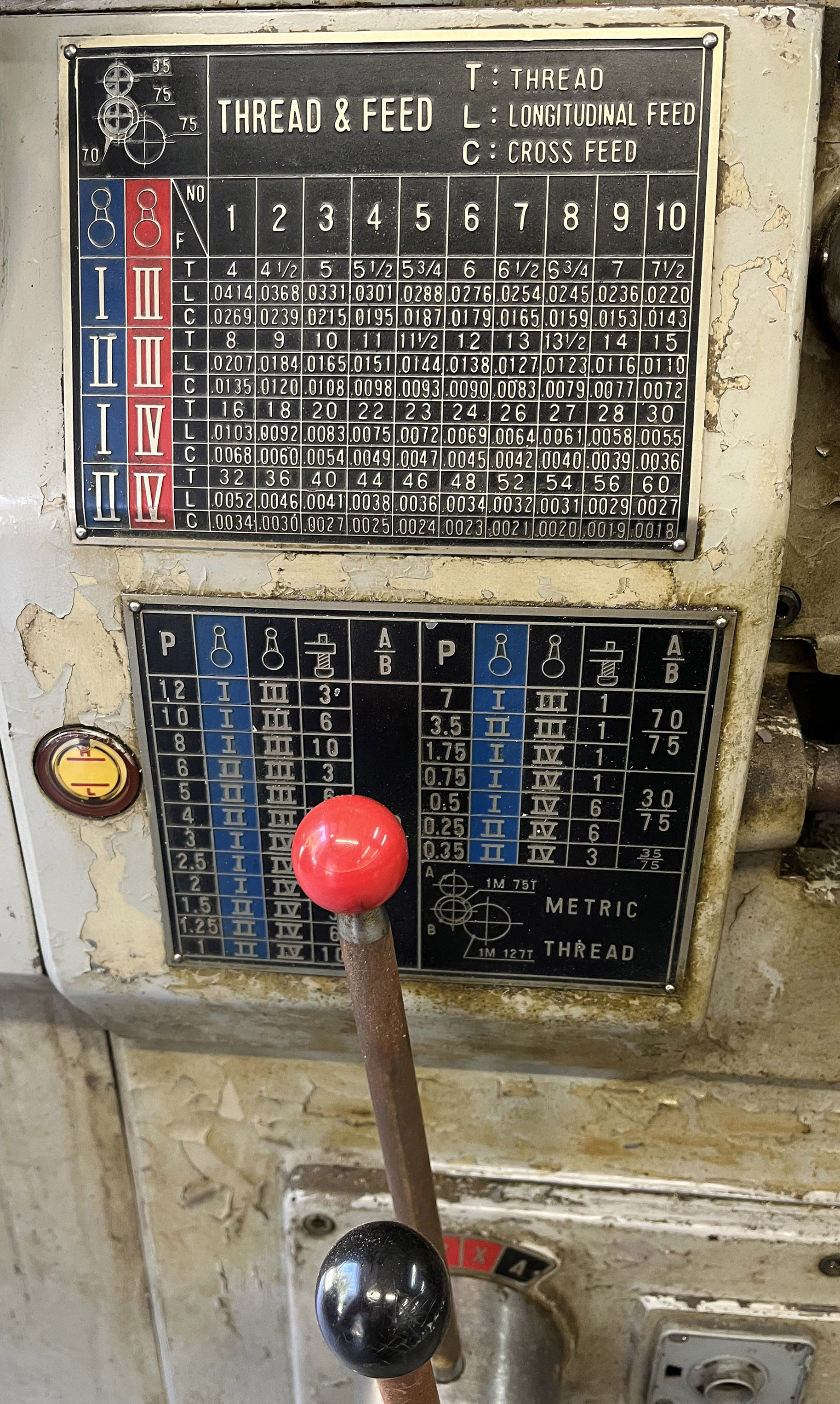

Fitted with a Norton-type quick change gearbox with a traditional tumbler-lever selector, the lathe could produce English pitches from 4 to 60 t.p.i. and, when fitted with metric transposing changewheels of  127, 35, 70 and 75 teeth, metric threads from 0.25 to 3 mm pitch could be generated. Longitudinal carriage feeds ran from 0.027" to 0.0414" inches per revolution of the headstock spindle and cross feeds (as usual on this class of machines) at half those rates.
