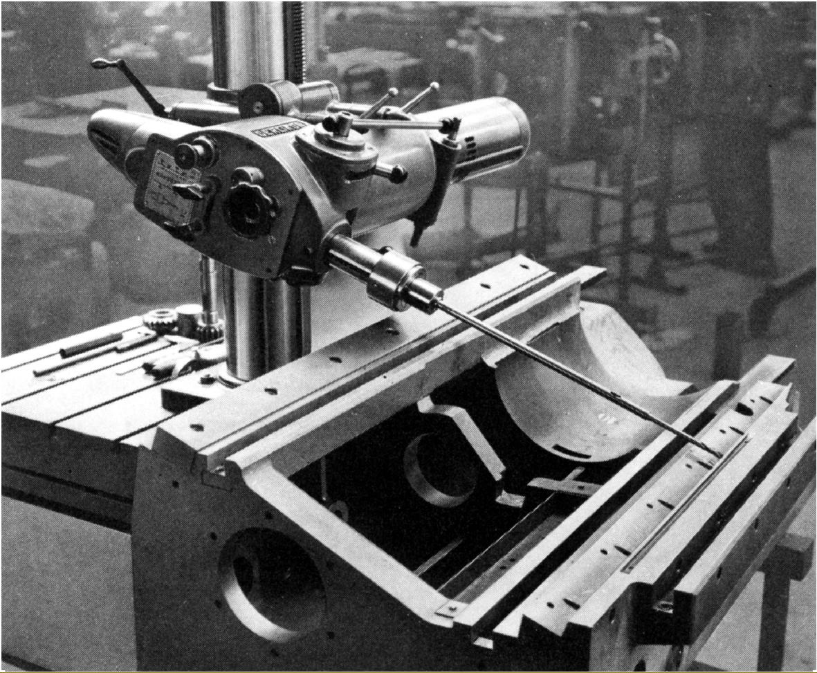

Drilling into an awkwardly positioned flange

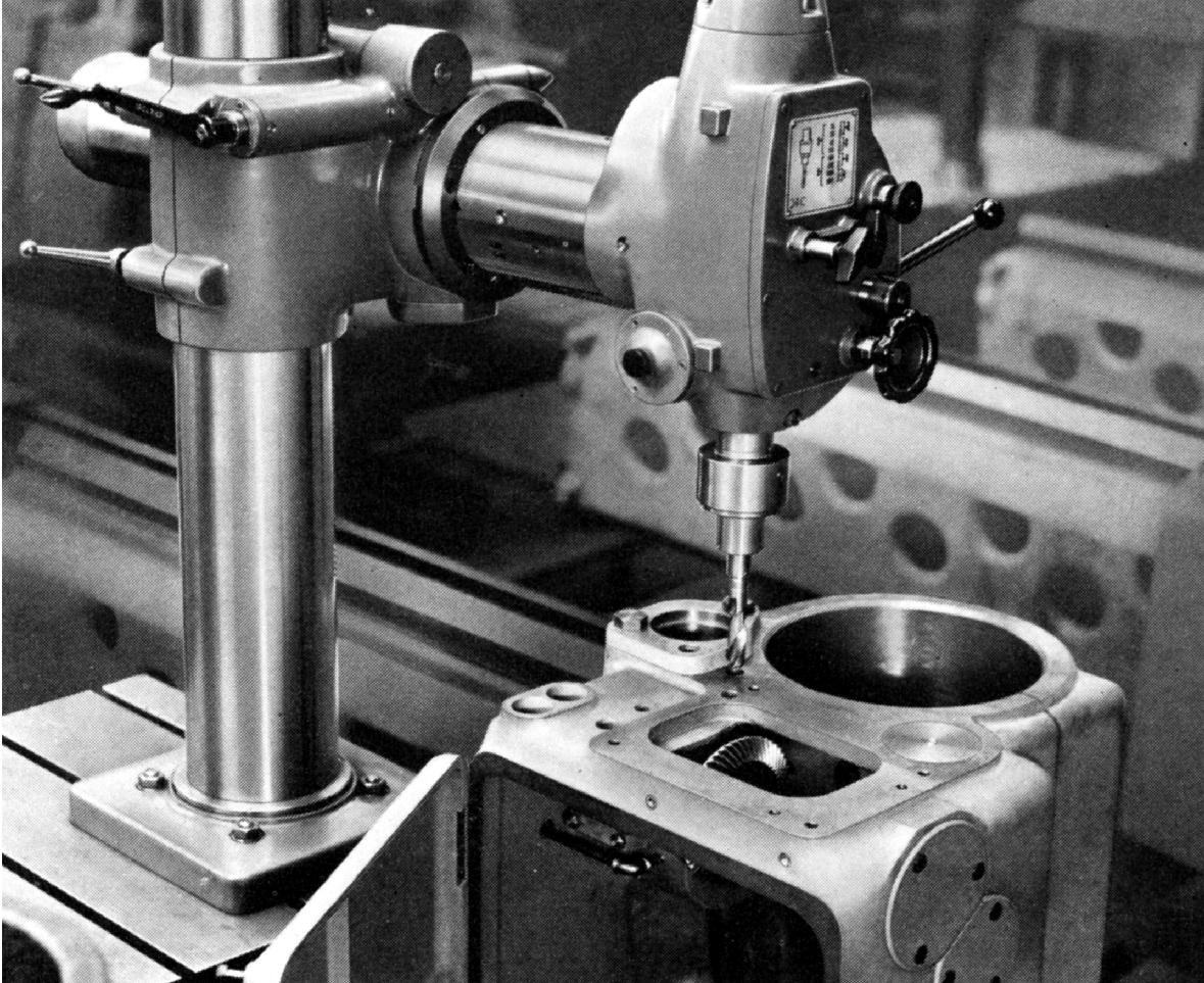

Drilling into a confined space
