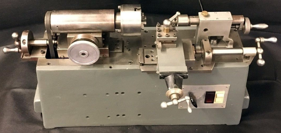

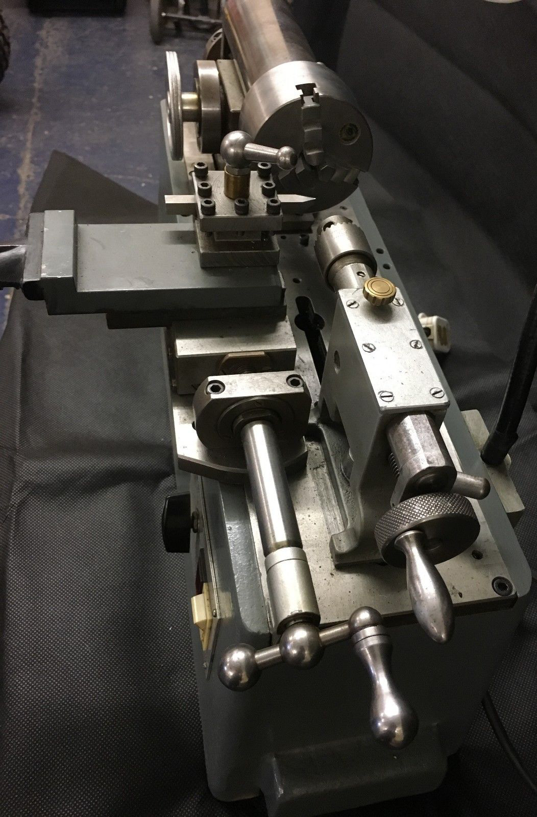

The basis of the 85 mm centre height "slide-rest" Nissel lathe was a 24-inch long and 8- inch wide box-like iron casting with, secured by socket-headed screws to its top face, a steel plate upon which were mounted, in turn, separate slideways for the compound slide-rest assembly and headstock. As the headstock could be moved along the bed, the small, variable-speed DC motor was bolted in place beneath it, the drive being direct to the overhung end of the headstock spindle by a sort, Z-section V-belt.
The slide-rest plate was fixed with, at one end, a flange through which passed the feed screw -  this being set parallel to the front face of the bed and supported at its far end by a bracket attached to the right-hand face of the stand. The operating handle was of the "balanced" type with the finger grip being able to rotate. Using the end bracket, feed screw and nut from an ordinary Myford ML7 lathe, the short-travel top slide was cut away on its top surface to allow the 4-way toolpost to sit low enough for the cutting tools to reach centre eight.
Avoiding all the complications of boring, honing and fitting-up a high-accuracy tailstock (as can be found, for example,  on any Schaublin 70 lathe) the Nissel used an assembly with the spindle machined flat on top and held in place by a flat place screwed to the casting. Drive by a Victorian-style "drop-down" screw - the end of the spindle being fitted with a flange that fell below the spindle line, its lower section forming an abutment face for the feed screw to pass through.

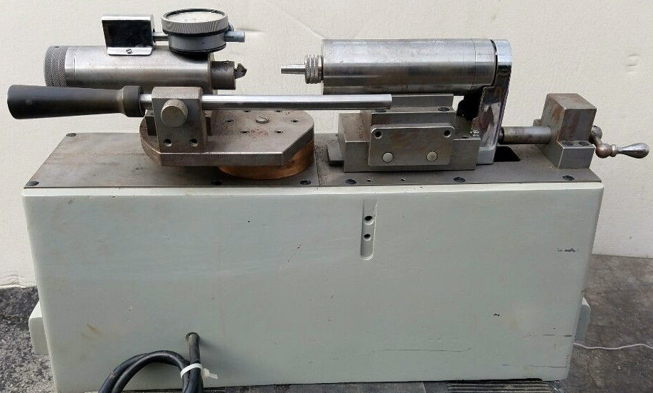

The "spherical-turning" Nissel was of identical general arrangement, but with just a swivelling toolpost that allowed a radius to be formed on the end of the workpiece.

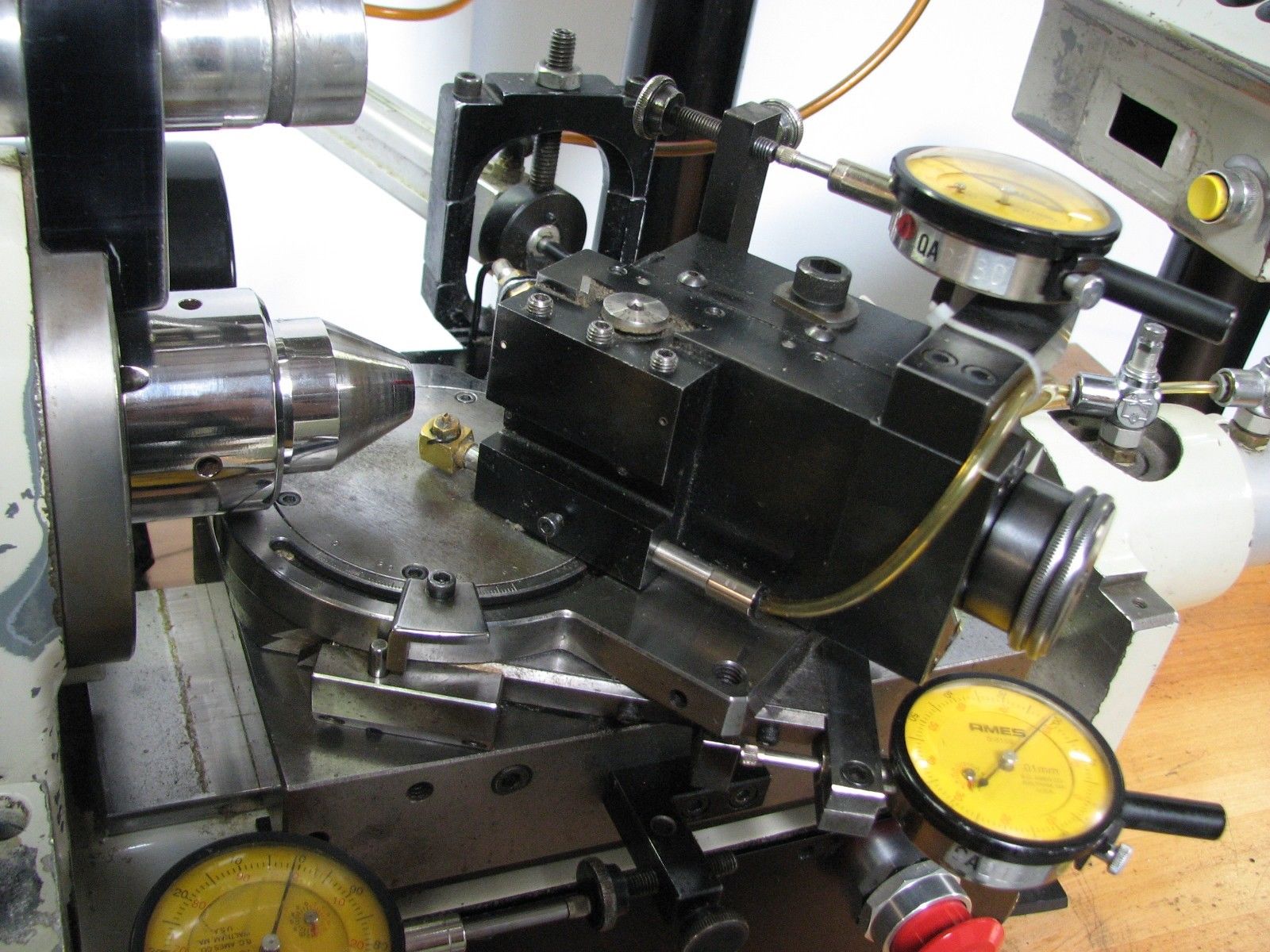

A "spherical-turning" Nissel
Another version of the Nissel spherical-turning lathe

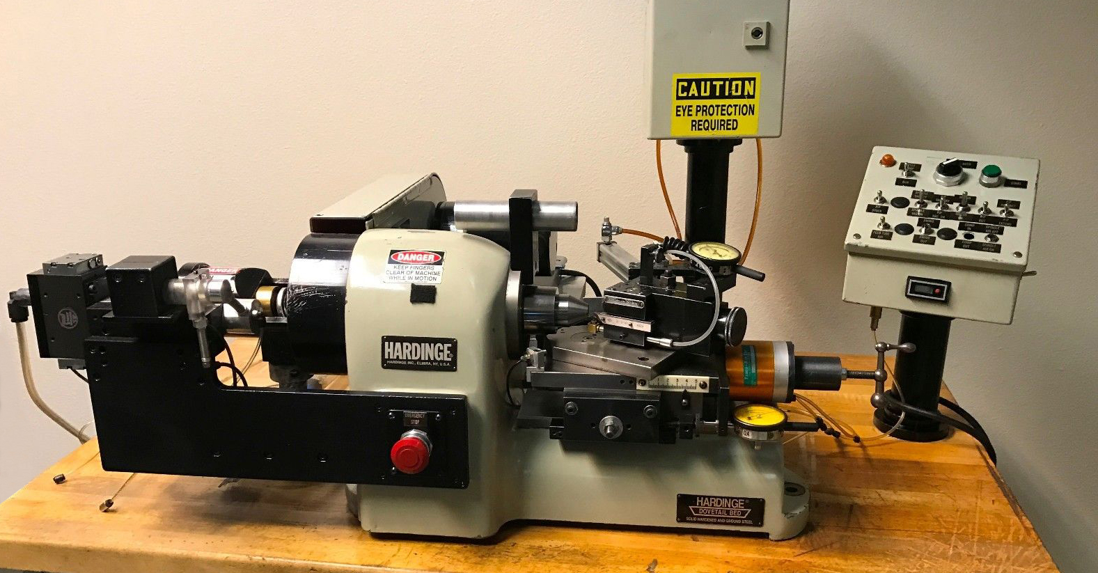

The rather more Complex American Hardinge lens-turning lathe
