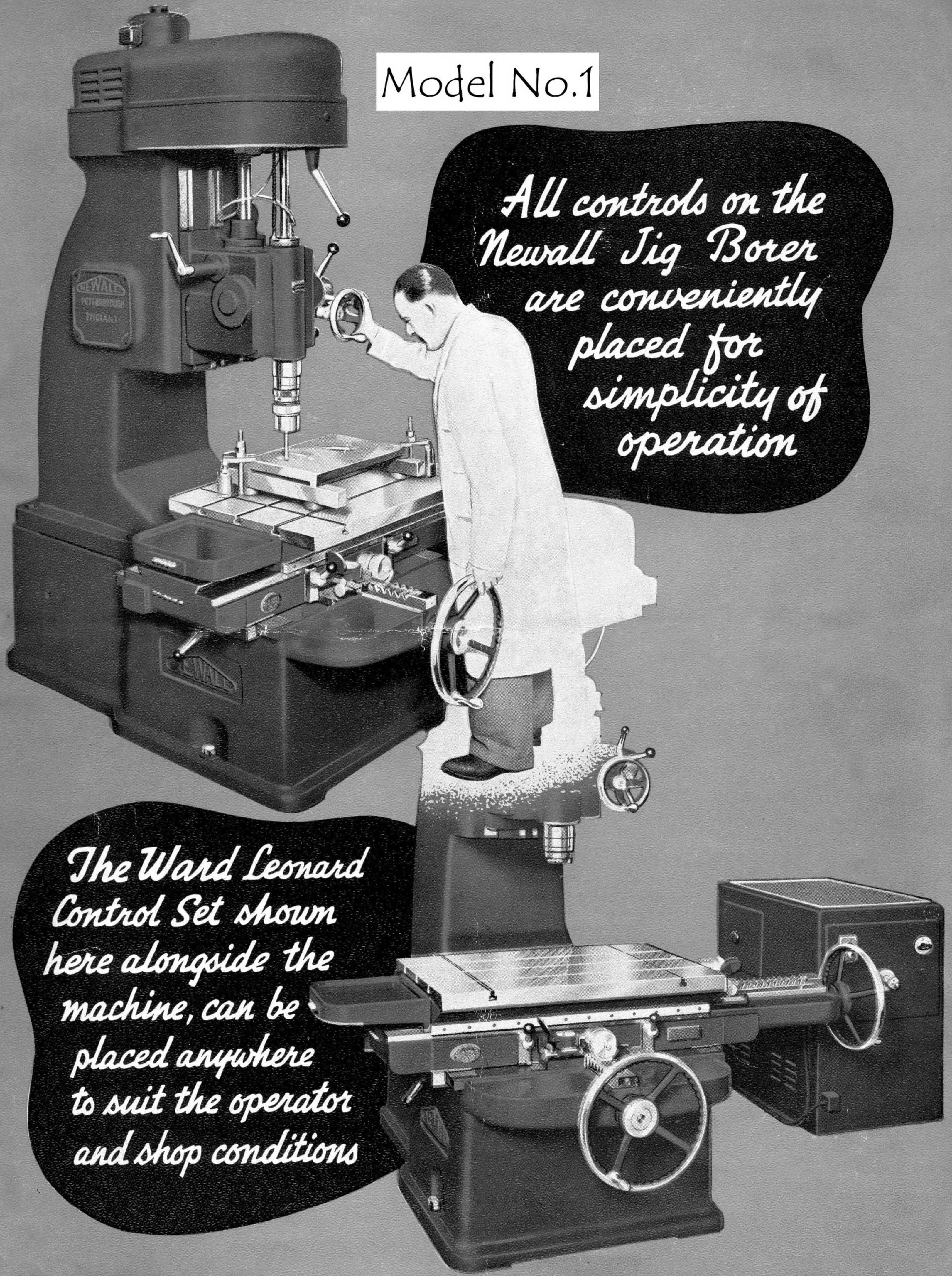

Newall jig borers were first manufactured in the late 1930s as the Models 0 and 1. These were then followed by a whole series, some of a unique design, others modified from an existing type of listed as a distinct model by virtue of the measuring system fitted. It is believed that production ended in the lathe 1980s. In addition to the No.0 and No.1 models included the No.2 - and then a series whose model number reflected the size of the table in inches rounded to the nearest whole number - the 1520, 1520 Jig Grinder, 1520 Machining Centre, 1520 Spacematic Numerically Controlled, 2030, 2435, 2436 Optiset, 2436 Mk.2, 2442, 2443, 2451, 2657 Pacematic, 24A51 and 26A57.

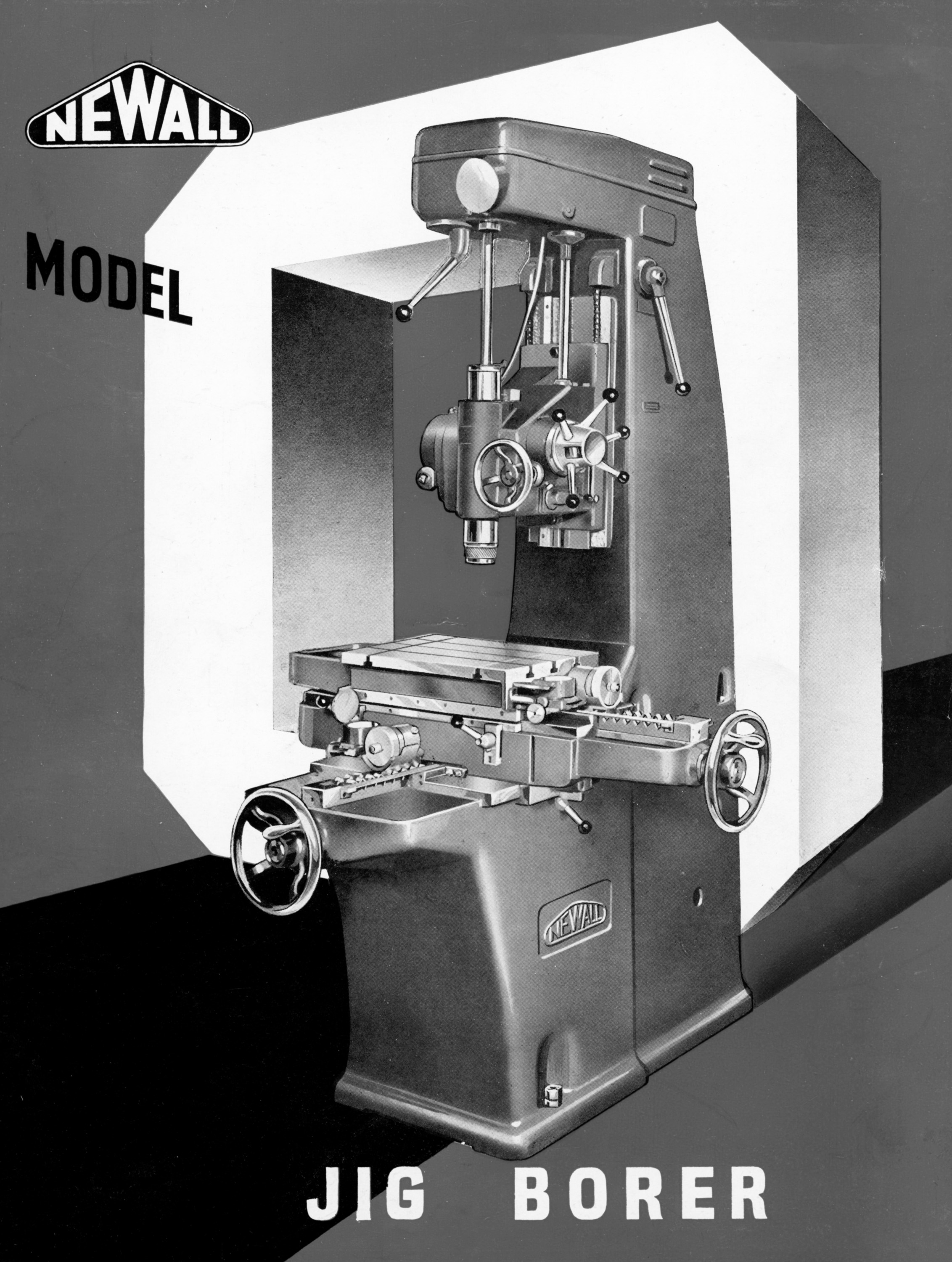

Smallest of the Newall jig borers, the Model 0
