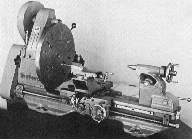

1951 Myford ML7 "High-swing" lathe of about 6" centre height. Made to special order during the 1950s, these lathes were used by the brake and clutch lining firm of Ferodo Ltd. (of Chapel-en-le-Frith, Derbyshire), to equip their motor and motorcycle-racing service vans. In the days just before the introduction of discs, drum brakes had grown to enormous sizes and a lathe was required which, while needing to be of only relatively light construction, had to be able to turn large diameters. A full-sized lathe would not only have been unnecessary, but also just too unwieldy and heavy to transport. Although suggestions have been made that the lathe was designed for turning brake drums it is more likely that the large faceplate carried jigs to hold brake shoes and clutch plates and so enable them to be turned true after being relined. Although the headstock was raised by using a simple distance piece, the tailstock base was a special and rather well-designed casting. The cross slide, its end bracket and the zeroing micrometer dial were of the "Super 7" type used on long-bed ML7s and the (Super 7) top slide sat on a neatly-cast hollow block that brought it out to a position where the cutting tool could be made to reach the outer area of the faceplate. Not all High-swing lathes were fitted with screwcutting, some have been found as plain-turning models, though it is believed that all retained their slow-speed backgears. When fitted, the changewheel drive to the leadscrew was provided with a necessarily-longer banjo arm, the covers being fabricated on early models but later in cast aluminium as on the standard machines. According to the long-serving work's engineer, although tentative plans had been made to market the lathe, apparently made, nothing further was heard of the idea. At least one standard centre height Super 7B with a capacity of 60" between centres was also made - and last reported to be in the north of England in the late 1980s
Myford High-swing ML7 fitted with its giant faceplate

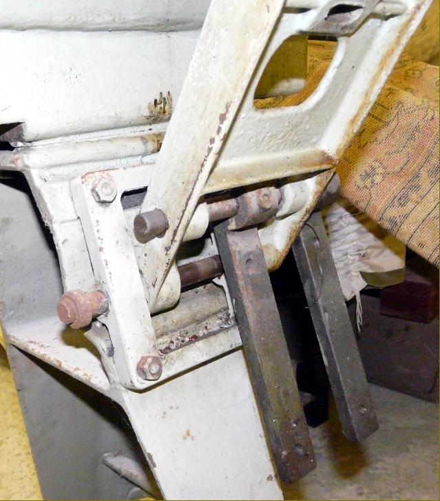

A rather neglected High Swing Tri-Leva missing its leadscrew, hanger bearings, changewheel banjo and tumble-reverse mechanism. The top-slide raiser block is fitted back-to-front

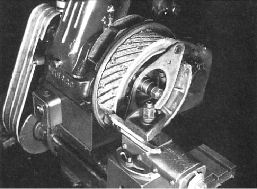

A High-swing being used to machine a set of relined brake shoes. Note, on this version, the fabricated changewheel cover

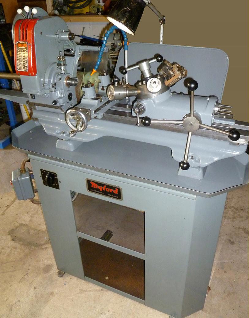

Myford C7 Capstan. An early version (identifiable by the screw-feed cut-off slide) fitted with a Tri-Leva spindle-speed selector, standard bed-mounted capstan unit, coolant unit and two-speed electric motor. Other dedicated Myford capstan lathes were also manufactured, based on the pre-war ML2 and ML4 beds and also a very rare machine, the ML6 (see below) with 4-inch diameter taper-roller bearings in the headstock and specially constructed for repetition work; this model was, unfortunately, never sold equipped as a centre lathe.

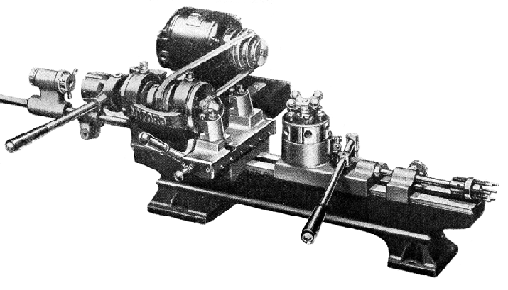

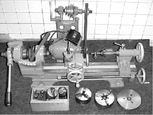

Although, during the late 1930s, Myford had produced a useful little capstan lathe that used the bed of a slightly modified ML4 lathe, this was not a machine capable of absorbing thousands of hours of hard use at the hands of unskilled operators. With war-time demand for any kind of production lathe running at a high level, and with little on the market as competition in the very smallest sizes, Myford introduced several capstan versions (of confusing specifications) including the short-lived ML6. While this used the same 6-station self-indexing capstan turret head and cut-off slide from the ML4 capstan, the headstock and bed were completely different. The large-bore spindle ran in massive ball or roller bearings and has been found fitted with a variety of pulleys: 1 and 2-step flat and 3-step V-belt, with the drive coming either directly from a 0.5 hp 3-phase motor or through a stronger version of the adjustable-type, swing-head countershaft as used on the ML2 and ML4 lathes. To stabilize small diameter stock as it was fed through the spindle, a properly-engineered adjustable steady was bolted to the left-hand face of the headstock. The spindle was fitted with a well-made, lever-operated collet closer that pivoted from a heavy bracket formed as an extension to the headstock casting behind the left-hand bearing. The closer operated through the usual toggle mechanism - and used collets of the standard and widely-employed "dead-length" type. The bed bore some cosmetic resemblance to that used on the 4-inch " Precision", and so deeper and much more heavily built than that of the amateur-market ML4. Several version of the ML6 appear to have been produced: one was assembled as a pure capstan lathe with a simple cut-off slide and a lever-operated, 5-station self-indexing turret that bolted to the bed (pictured above), while another was offered as a plain-turning machine (shown below) The latter version was fitted with a tailstock and a carriage (complete with proper compound slide-rest) driven along the bed by a short, hand-turned leadscrew supported in two bushes, one positioned at the tailstock end of the bed the other a few inches in front of the headstock. Another similar small capstan lathe offered during the early 1940s was the ML5 - this appearing in several versions (both shown below and here) with their serial numbers prefixed by either an "F" or "G". There was an almost bewildering variety of bed and headstock combinations, with some of the latter having ordinary split plain-bush bearings, others using the same (or a very similar) headstock casting but with ball races fitted and yet others with heavier castings that lacked the bosses through which the bearing nip bolts passed - and obviously intended only for the fitting of ball or roller races. One must assume that these lathes were built in batches to order and so incorporated differences most suited to a customer's requirements e.g. a ball-race supported spindle for very high speeds involved in the turning od small-diameter components, or a wide, single flat-belt pulley headstock spindle for a repetitive job that needed a good strong drive. As so few of these machines have survived - most must have been completely worn out by the end of the war - production numbers are hard to gauge, but surely cannot have exceeded a few dozen of each. If you have a version of the Myford capstan lathe, or any literature about it, the writer would be pleased to hear from you.

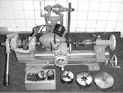

A Myford ML6 set up as a plain-turning lathe with compound slide rest and a hand-driven carriage assembly

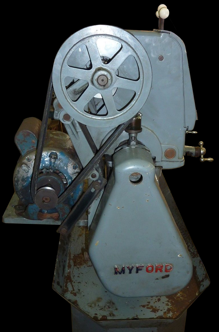

Possibly a one-off (and of unknown designation), the 4-bolt foot section of this Myford production lathe appears to have been cast from a pattern originally intended for the WW2-manufactured "4-inch Precision"

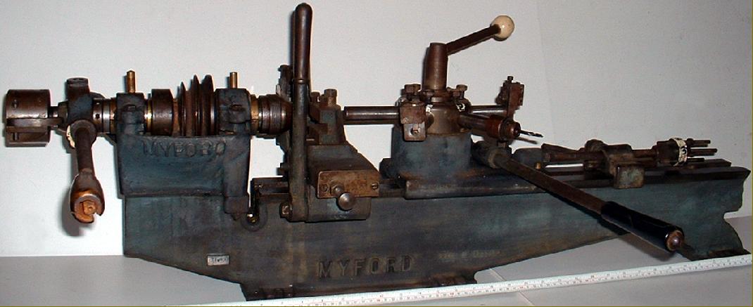

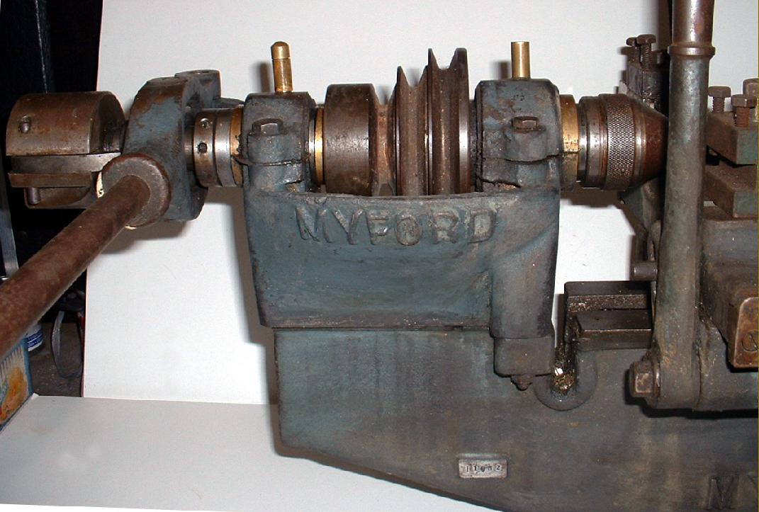

A very rare find - a complete and original Myford ML6 (Type H) on the maker's self-contained (motorised) cast-iron stand of a type adapted from that used for the M-Type
