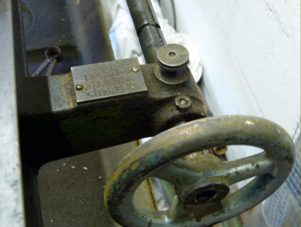

Drive to the 4 t.p.i. leadscrew was by 10 d.p. changwheels, the usual very large set of around twenty being provided from 20t to 150t  that allowed threads to be generated from a spiral pitch of 71/4"  to 150 t.p.i.  The changewheels also powered the sliding and surfacing feeds, the drive being taken to the rear from where it connected to an exposed 3-speed gearbox -  this turning a keyed shaft that ran down the back of the bed. The shaft passed though and turned a wormwheel held in bearings built into the back face of the saddle, the feeds being selected and engaged by a full-circle handwheel at the tailstock, the pulling and pushing of which caused the shaft to be slid endways into three notched positions - plus one for neutral. A bronze plaque showed the feed rates: 32, 64 and 128 for sliding and 64, 128 and 256 for surfacing - these presumably being decimal fractions of an inch per one revolution of the headstock spindle. Rear-mounted power-feed drive was a common fitting on lathes of the 1800s, examples being made by another Manchester company, Spencer, whose larger lathes were so equipped as well as ones from the Liverpool maker Jones & Burton. Surprisingly the design lasted into the 1930s with Pool using the system on their larger lathe for amateurs, the Major. Probably the very last lathe to be so equipped was the English Mellor, a very heavily built small lathe current into the 1940s.

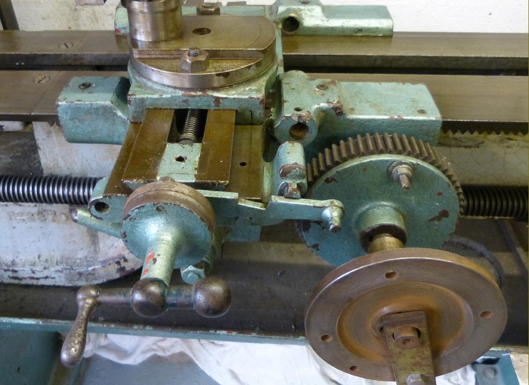

One unusual feature of the Muir lathe - and possibly unique in its arrangement - was a quick-withdrawal mechanism for the screwcutting feed. Instead of the bearing for the cross-feed screw being direct in the casting of the saddle, it was carried in a short-handled screw of very coarse pitch threaded into the saddle casting. In operation the handle was held down to the right of the cross-slide handwheel by a spring-loaded catch, the job progressing until the end whereupon the catch was pushed in and the handle jerked upwards to pull back the cutting tool. To continue the job, the handle was pushed down and the cross-feed screw fed inwards a little. Some German Karger lathes used a similar but cam-operated system, possibly of the type fitted to this machine that incorporated an adjustable throw-out bar fitted just below the front edge of the bed.

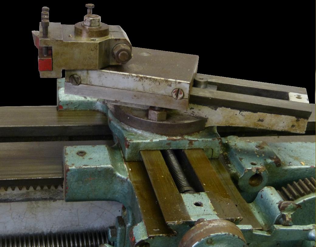

Rather unusually for the era, the cross slide was equipped with a generously-large micrometer dial though what was on the top slide is unknown, parts being missing from the machine shown. However, it is likely that the form of toolpost used is original, a quickly-adjustable "Norman Patent" type as found on the later very popular Drummond M-Type lathe.

A view of the now incomplete quick-withdrawal  screwcutting mechanism. The large full-circle handwheel to drive the carriage along the bed was originally a large crank type.

Power sliding and surfacing feeds were selected and engaged by a full-circle handwheel at the tailstock, the pulling and pushing of which caused the shaft to be slid endways into three notched positions - plus one for neutral - these being secured and released by a vertical plunger. A bronze plaque showed the feed rates: 32, 64 and 128 for sliding and 64, 128 and 256 for surfacing - these presumably being decimal fractions of an inch per one revolution of the headstock spindle
Unfortunately now missing several parts, the wormwheel and its connection to the carriage

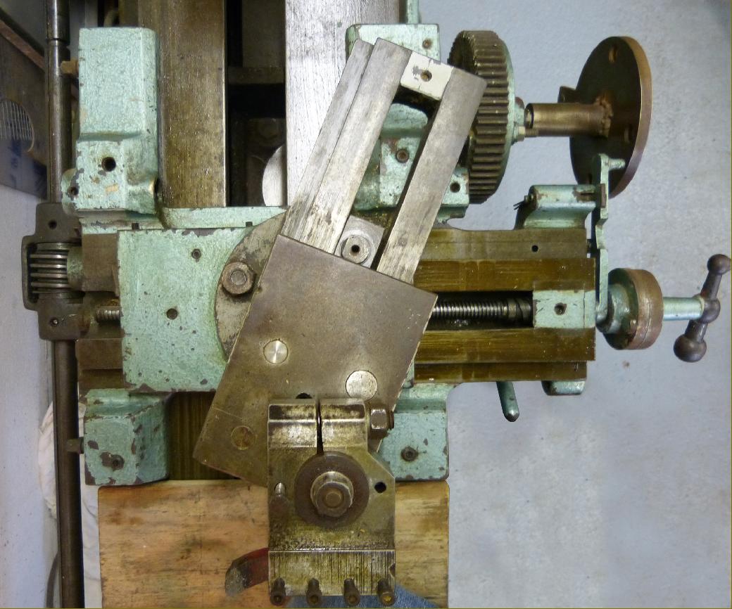

The original (now incomplete)  top slide
