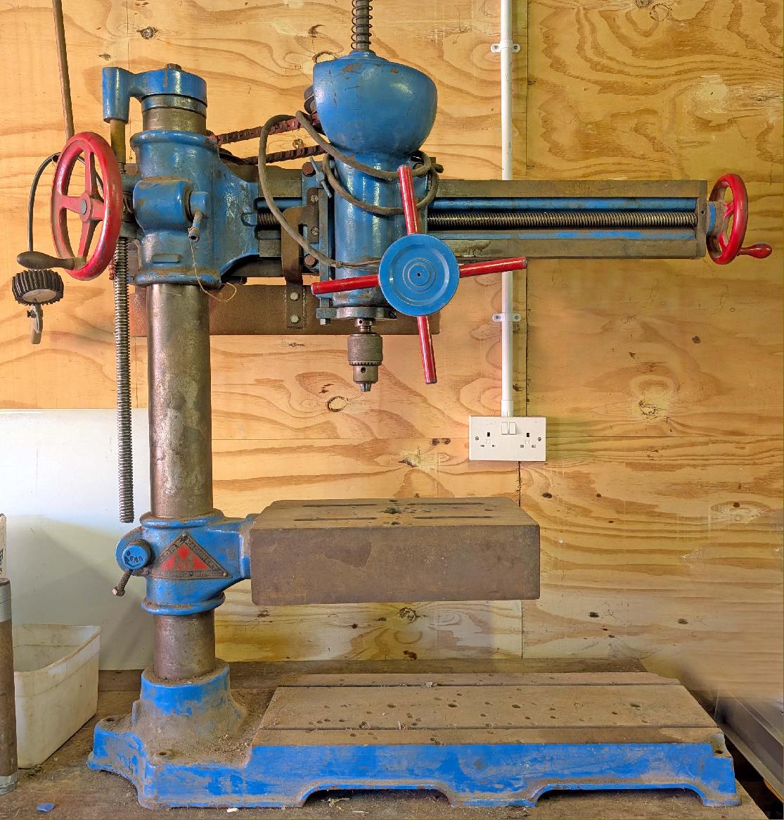

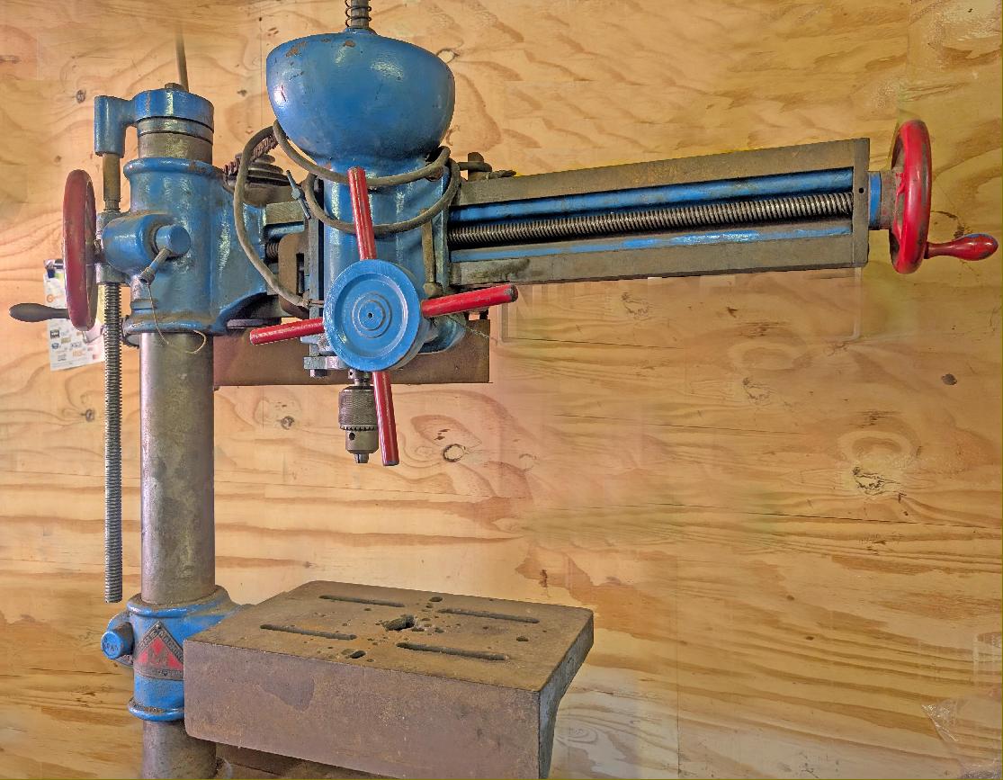

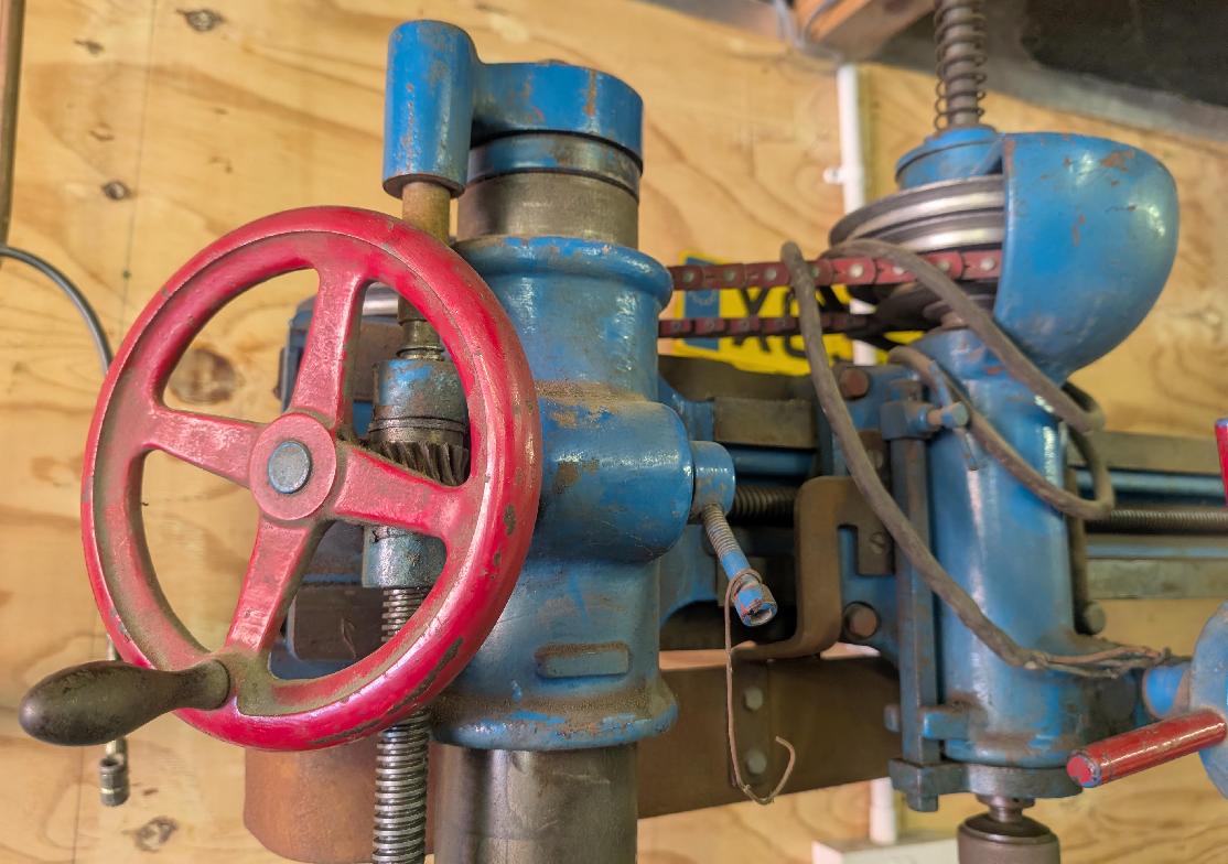

Manufactured by the Moore Machinery Company of Los Angeles and San Francisco, this "miniature" radial-arm drill must be, if not unique, then certainly very unusual. The drill is in England and so, in all likelihood, would have come over during WW2.
From the centre of the 85.7 mm (3
3/8") diameter column, the arm is 760 mm (30") long and has a rise and fall of 610 mm (24"). The head travel measures 460 mm (18") and the quill, with a No.2 Morse taper, has a feed of 130 mm (51/8") under the control of a capstan handwheel. Machined with just two widely-spaced T-slots to take 5/16" studs, the work area of the base is 635 x 255 mm (25" x 10"). There is also a mounting for a small swivelling rise and fall table but, unfortunately, this was missing when the current owner obtained the machine.
