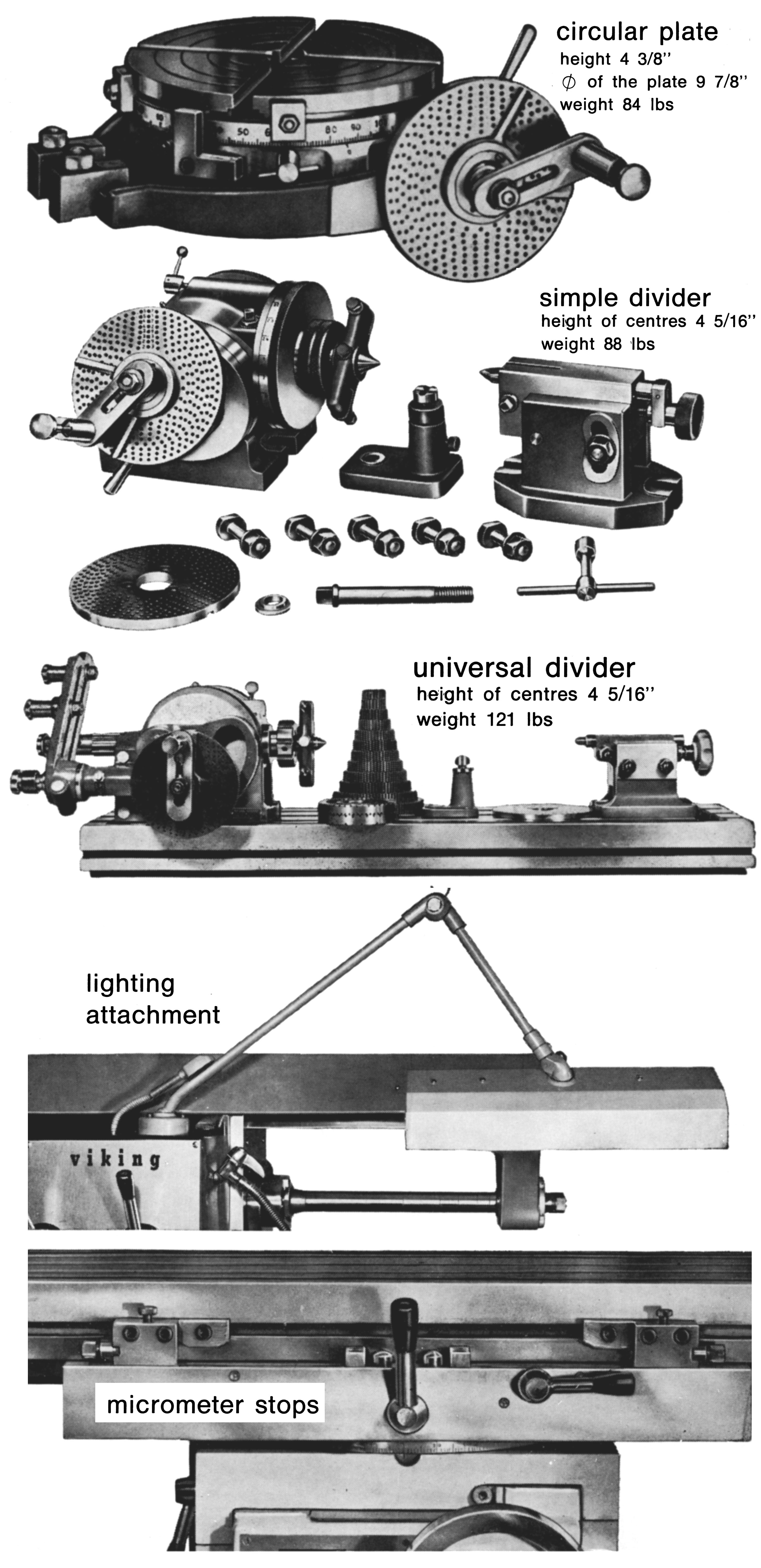

Available as an extra was a 4
5/16" (110 mm) Universal Dividing Head complete with a tailstock and able to hold something like 20" between centres. Details of the unit are uncertain, but it's likely, comparing specifications for similar types fitted to milling machines of the same capacity, that the indexing plate would have been double-sided and capable of providing all divisions up to 60, all even numbers and those divisible by 5 up to 120 as well as all common divisions up to 400. By using differential indexing, other divisions could also be obtained.  For milling spiral pitches with a lead of less than 0.1", the worm gear could be disengaged and the dividing head spindle connected to the table feed-screw by changewheels, a set of twelve which was provided. This system increased the rate of rotation of the spindle in relation to the speed of table advance, and so allowed very fine pitches to be generated.
Other accessories, in addition to those already mentioned, were machine vices, a basic dividing unit with indexing plates and a tailstock; a 10-inch 250 mm) diameter rotary table with division plate, a light unit, table travel stops fitted with micrometer thimbles, a selection of horizontal cutter holding arbors, cutter holders, and various collet chucks.
