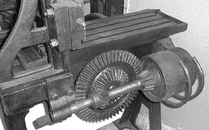

The first automatic table drive reversing system that Milnes used (though not unique) was ingeniously arranged; a countershaft unit with a 3-section "fast-and-loose" pulley set was driven by a single belt that passed between two striker "hooks"; the hooks were controlled by a mechanism linked into the machine's motion in such a way that they could throw the belt from one outside pulley to the other. If the belt-shifting mechanism was disengaged, the belt came to rest on the centre "loose" pulley which, being free to spin on the shaft, stopped the feed. Reference to a photograph towards the bottom of the page shows one of the forms of table reverse fitted to Milnes planers: a single shaft emerged from the drive pulleys and carried, at each end, a pinion gear - each of which engaged with its own crown wheel, the two wheels being mounted on concentric shafts. With the belt positioned in the middle, or idle, position, the drive was started by lifting a lever that engaged the belt-shifting mechanism. The belt was moved first to the right-hand pulley which drove the outer of the two pinion gears; this advanced the table (by means of a rack fitted to its underside) under the toolbox and metal was cut. As the table came to the end of its travel a trip bar caused the belt shifter to fling the belt across to the left-hand pulley, and so engage the drive to the inner of the two pinions. Being "higher-geared", this returned the table at a higher speed to its starting point with the tool-carrying clapper box being knocked back on its hinge as the workpiece passed beneath it; from the returned position the cycle began, automatically, again. Later Milnes planers (as shown below) had a very much more compact drive system that, while it retained a fast-and-loose pulley arrangement, employed a conventional gearbox mounted beneath the bed. On all models from the basic hand-operated type to the larger power-driven versions, the cutter head was also power fed across the job by the use of a simple ratchet feed, this being operated by a long rod that reached down and engaged with the table drive mechanism..

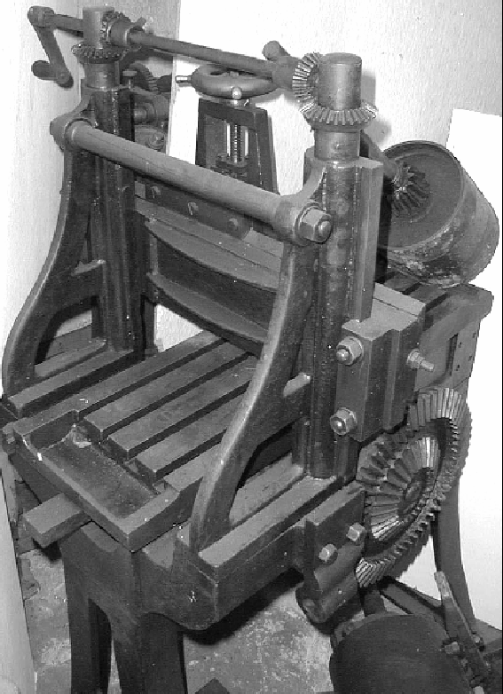

A Milnes No.2 Planer from the 1920s in as-found condition

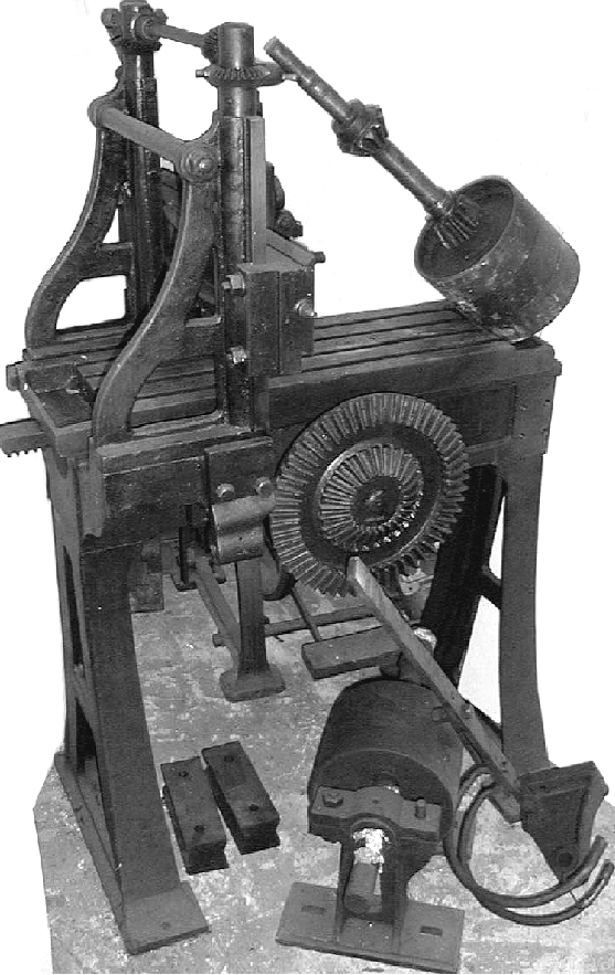

Trial assembly of the input drive pulley system with its fast-and-loose pulley drive and belt striker bars
Trial assembly of the control system
Later-type Milnes planer table drive gearbox
The two cast-iron uprights that carried the tool-holding bridge

Early design of Milner planer table drive and table reversing mechanism
